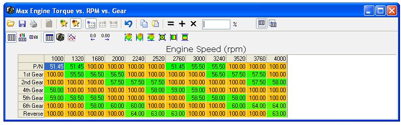

Originally Posted by turbofreak
Exactly, I was running 25 psi with Westers race tune. Now I have a GM stage
tune. Also have HPT so I can change at will after Lyndon retunes the GM tune.
The boost hits alot slower on the GM tune. The Westers hits with a rush.
The GM tune hits softer on a purpose tohelp protect parts. Thus the low rpm
on aftermarket is stronger but both are strong above 3500 on up.
BUT and it is a BIG BUT, the GM tune does not cause the clutch to slip in
4th or 5th gear. The boost is less than race tune but when the aftermarket
was lowered to similar boost as GM, the clutch still slipped- again I feel due to
how hard the boost hits. I believe the aftermarket can be modded to have best of both worlds. Before with race tune, I just stayed away from WOT
at the 3200 rpm range unless I downshifted.
The GM tune has bands where they are limiting the torque until after ~4000 RPM, obviously for a reason. I don't point and stab anyways, I roll into it.
Where in MI? Who did your stage upgrade?
GM Tune is not limiting the torque above 3000 rpm
This is where I go that info from. That being the case it isn't correct then, or my interpretation of the information is incorrect.
either way no limitations above 3000 rpm
Thanks.
