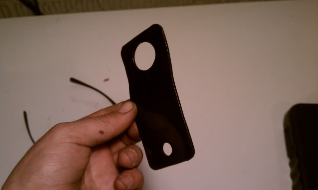

Well I took the plunge and ordered the stage 1 with wire harness from crateenginedepot. I have read the tons of threads about trimming tabs and clearance issues. So, I have provided that info including links and a pic of the bracket some have used to keep the charge pipe and sensor away from the AC compressor. I know a quick flash from trifecta was cheaper and easier but my warranty is important and I plan on renewing it since so many are getting high miles out of these cars. I figure if they get the install right it will be fun and if I ever do want another tune I'll have the 3 bar sensors to hopefully be able to read more boost later if I want. I don't know, I guess we'll find out but reading many positive reviews on the stage 1 I figured I wouldn't risk the warranty.

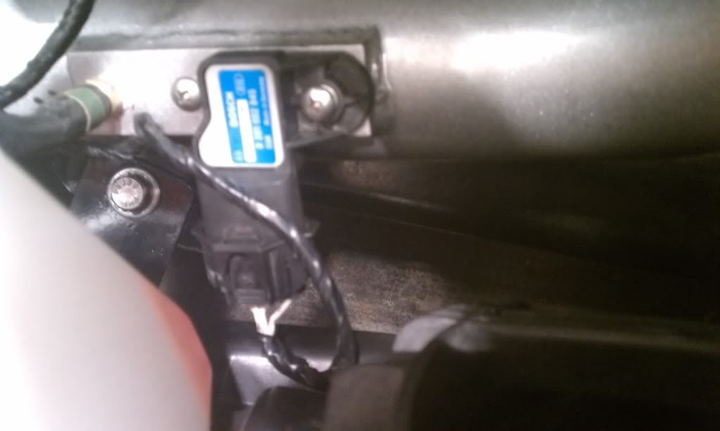

GMTU is good but trifecta/hp unlocks a shat ton more power. If your warranty is important to you, you did the right thing. Piece of mind is worth lot$. I had fabbed some simple custom lower radiator brackets to move radiator forward enough to flip sensor 180 with tons of clearence between rad and sensor. Been thinking of making a bunch more of the mounts so others can do the same mod. Here is one of the mounts.
Plenty-o-clearance
Plenty-o-clearance
You will like it, it's a whole different car with 20+ lbs boost. Get ready to shop for tires......

No I did not flip the Map 180 degrees.
I was the one who found the clearance issues back in 08. I was lucky to be in contact with the GM engineer who handled this program. The correct way to fix the clearance issues is to make sure the tube is on the IC all the way and if you need more space just use fender washers to move the IC forward.
You can try to flip it but there are times there is little clearance to the front too. Also putting in a bracket needs to be done with care as the tube was made to move with the rotation of the engine and as it gets older you could fracture the tube. It was not made to be limited.
You need very little clearance and odds are you will have no issues with normal installation. It just closes the gap when under acceleration.
The IC is not an exact fit and cam vary a little in many SS. Mine was off due to an accident that required replacement of the IC and it was just bolted in back more.
You do need to remove the bumper cover to space the IC forward but it is the correct way to do this.

I would just have them install it as per the instructions and if the map should hit then have them shim the IC forward and you will never have another issues. If it does not hit then leave it alone as you are ok.
