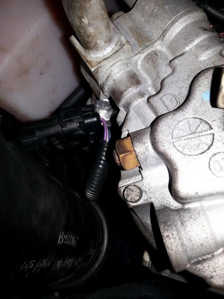

I don't even know where to begin. This kit ROCKS. This is a whole new vehicle. Going from the choked auto to now this is unbelievable. I'm hitting 23+ lbs of boost and taking off like a rocket. Below 40mph the tires struggle to catch if I floor it and broke loose causing the traction control to kick in. Taking off from the line full throttle is impossible. Even at 60mph if I floor it its 23lbs and off like a shot. This is nuts. You can also hear the turbo whistle more now as it spools up. It's unreal.
The service mgr and Corvette tech that installed it want me to bring it back for a ride as it was raining when I picked it up from them and the roads down there were wet. They want to see it to believe it with the boost and performance numbers I was giving them. Turns out they hadn't installed this kit yet.
As for the install, he wants to kill the folks that decided to just go with this lower TMAP instead of designing a new one. He said there was NO clearance at all when he installed it. He considered the intercooler push forward and the bracket. He was worried about putting a bracket to hold the pipe since it's plastic. He didn't want to push the IC forward because he showed me (because I apparently misunderstood which part of the bracket to put washers on) that if he inserted washers on the one bracket he showed me it would move the IC back toward the engine and he would have to mount the IC on the front of the bracket to move it away.
I didn't realize the instructions were to shim the bracket between the bracket and crash bar not the IC.
All that said, he noticed the charge pipe was secured pretty far out from the IC so he loosened it and pushed it on about an inch more giving the clearance in the pic below. Looks to me like about the same amount of clearance SS fan got with his metal bracket. We agreed I'd let it be for a while then check it or have them check it to see if there had been any movement of the pipe back off of the IC closing the gap. I hope it holds as is but if not, well I'm warrantied.
I'm just blown away by this upgrade. I can't imagine adding any more power for a while. I have to actually go practice my throttle control both on and off of competitive mode to master this lol.
Thanks for all the feedback and advice. If you're reading this considering tuning your SS (especially if you have an auto)....DO IT!!!!!!!
