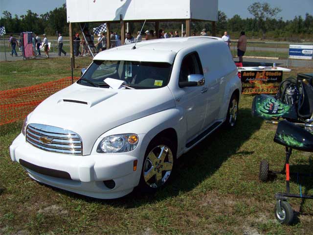

If you keep the air box, then seal it all in, that would make the ram sit off to the side a little bit, I think that would look pretty sweet, there is a guy around here that put a newer model mustang scoop on his Panel LT(functioning btw)

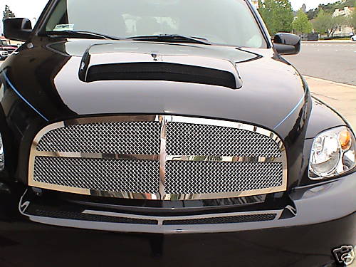

I personally really like this SS

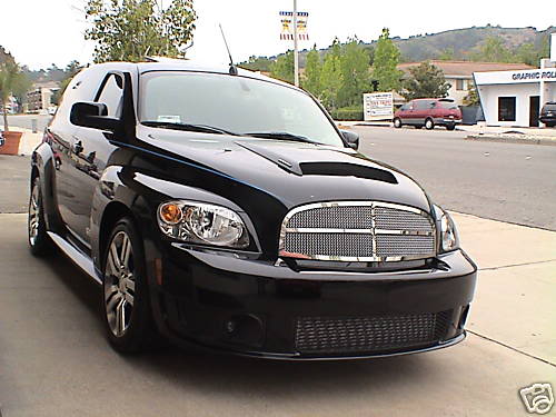

This is a scoop i found in a bargin bin at a giant auto, I had to cut out the holes, and then i made the custom grills, i think it fits the hhr's body style pretty good.
