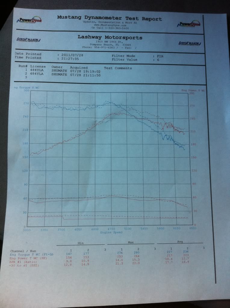

Results: 280tq 264hp
Dyno: mustang dyno
I'll explain later

womp womp womp.........
are you still on the GM Stage 1 tune?

with your mods meaning GMTU and boltons i did 286WHP 297TQ....
Its prolly those TTR mounts

Numbers were ok, don't forget the temp last night was 93 in the shop and heat soak was bad my temps were 130 or higher which didnt help. I also run out time on the dyno so I have to do get another dyno day. Hptuners is also limited on the hhr since there not the same computer as the cobalts. I also one of my couplings pop off on a run when I hit 26 lbs stupid clamps. It was a long day but I'll redyno and get some solid numbers before the heat soak.

get some t-bolts clamps while you're at it.
sorry but that's wrong about HPTuners being limited on the HHR, it is the same as the Cobalts. HPT isn't limited on my HHR.

Not limited on mine either... Excueses excueses
