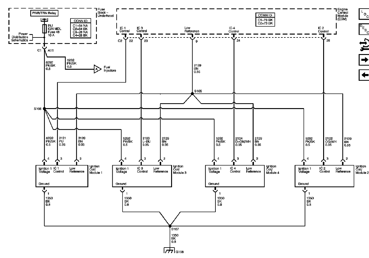

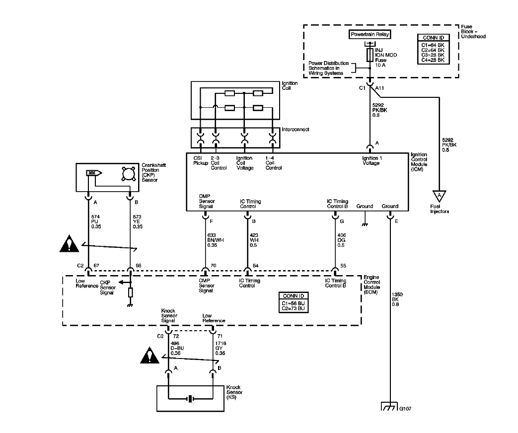

Here are the relative ignition schematics.
2006:
2007:
2006:
Attachment 21346
2007:
Attachment 21347

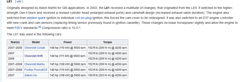

This explains the changes from 2006 to 2007.
