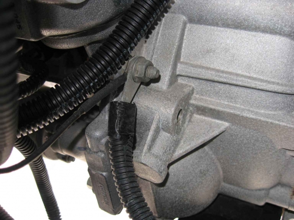

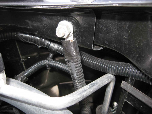

A lot of recent vehicle designs have the ground connection from battery negative to the front of the block, and a secondary ground wire, generally around 10gage, to the fender, that then ties all the remaining ground connection points to 0V. This one connection is then fairly critical, especially if additional loads are presented using a frame ground. The starter current, which is typically an order of magnitude higher than any other load, is conducted directly back to the battery.
With the battery in the back, the HHR cannot reasonably have that direct path, so traditional frame grounding is used. Pics below show the connection from battery to the bracket under the trunk floor, the connection to the engine rear face and the other end connecting to the upper rail just behind the radiator support. The ground path from the starter motor's internal circuits is generally the grounding of the negative brushes to the non-drive end cover, and then through the starter body to the flange that it's bolted to. Give the reliance on that ground wire from engine to fender for the starter current, I can guarantee that you'd know immediately if that connection was anywhere near bad enough to be an issue with any other ground path.
