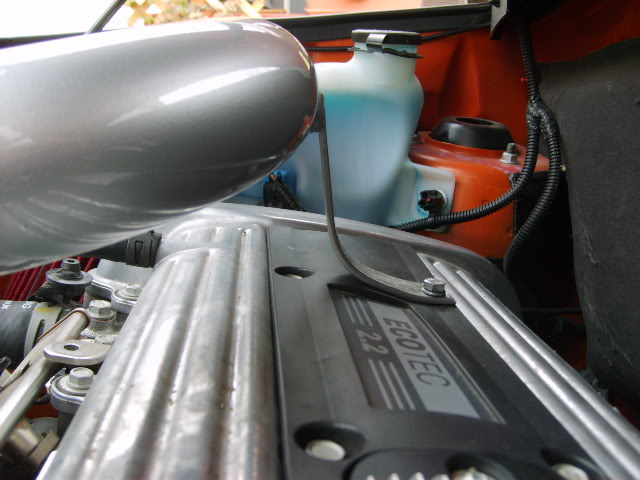

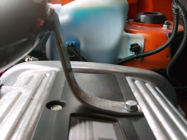

So i bought a used cgs intake(people getting rid of them left and right with the new gmpp intake now availible ) Came with instructions and a visual for a 2.4, But question is how and do you mount the support arm on 2.2? A pic would be really helpful.

It needs to be bent. Here is are a couple of shots of Deb's CGS showing the bar...........

yeah that was my biggest question, just cuz the bolt that came with the kit looked to be too short. thought that i had to take off the plastic thing that says echotech 2.2 but when taking it off realized that this was the ignitiion and plugs. Thats when i seen the length of the bolts for this. was just making sure though. So a 6 X 50mm bolt with 1" pitch and a flat washer does the Job? Looks like i'll be picking one up tomorrow. Thanks Guys and Gals

Just be careful when mounting it to that coil cover. There have been a few people (including Deb) that had issues where the plastic (on the coil) has cracked and over time, and it will eventually cause starting problems....Also on the 06 2.2L it will need to be tweaked so that it wont hit the hood strut, and rub the hood pad liner, and sit crooked.....
