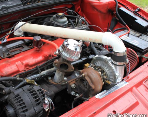

If you have deep pockets and plenty of time, yeah you can turbocharge anything, is it practical...probably not. As George so aptly pointed out, supercharging a 2.2 is easier to do, not easy by any means....but "easier".
And for Heaven's sake don't do what this guy did.
