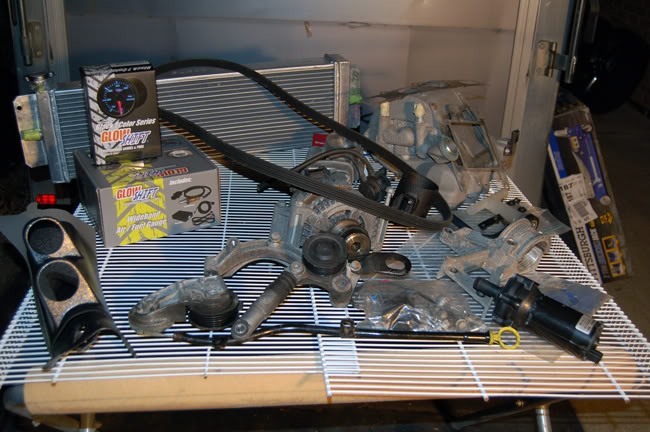

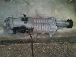

Yes it can. You can buy the ZZP Kit, or save a couple bucks and piece a kit together yourself.
Doing mine soon on my '08 2LT 2.4 Panel.
The 2.2 I think it also depends on the Year of your HHR?
More with reply with more detailed info.
My install is on hold at the moment as HPTuners has some kind of a Problem with it recognizing the Panel's Vin as a Valid Vin #. I am hoping they get a FIX for that Very SOON.

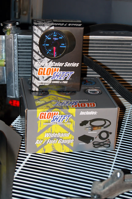

A&P where did you find that dual gauge a pillar ??

Universal from Glow Shift, same place I got my Gauges. Lots of MOD work needed to make it Fit. But that gonna be with any universal one you buy.
Since no one is making a dual HHR gauge pod.
