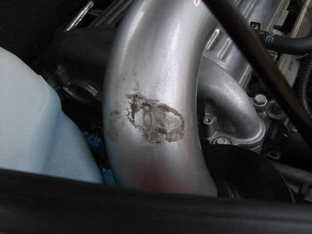

I had a problem with mine to begin with too and had the rubbing issue. I do have the 2.2L which requires some modifications to the CGS to eliminate the problems. Here's some of the things I have done that have eliminated the problem with the clunking and rubbing against the hood strut.
If you've got the rubbing against the hood strut like this

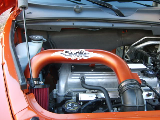

Go to Home Depot or Lowes and buy some pipe insulation like I did. (see upper left hand side of photo) You can buy a short length for a couple bucks and cut it to fit on the strut. It will soften the rubbing noise and protect both pieces from further damage. If you get the right size, it will wrap around the strut and you can peel off the plastic and the 2 pieces will adhere to one another. I put this on as a temporary solution after the above damage and decided to just leave it there.
If you have a 2.2L like mine, I have a how to do some modifications...see the thread below...paying particular attention to post #18 for measurements I used when making 2nd set of adjustments for 2.2L.
https://www.chevyhhr.net/forums/2-2l-performance-tech-5/even-females-can-install-cgs-3430/
I do have my Outlaw filter in there quite snug and have no more clunking, however, if you still experience some, take a piece of the foam used above to put between the filter and the inner portion of the body and that should eliminate the noise completely.
