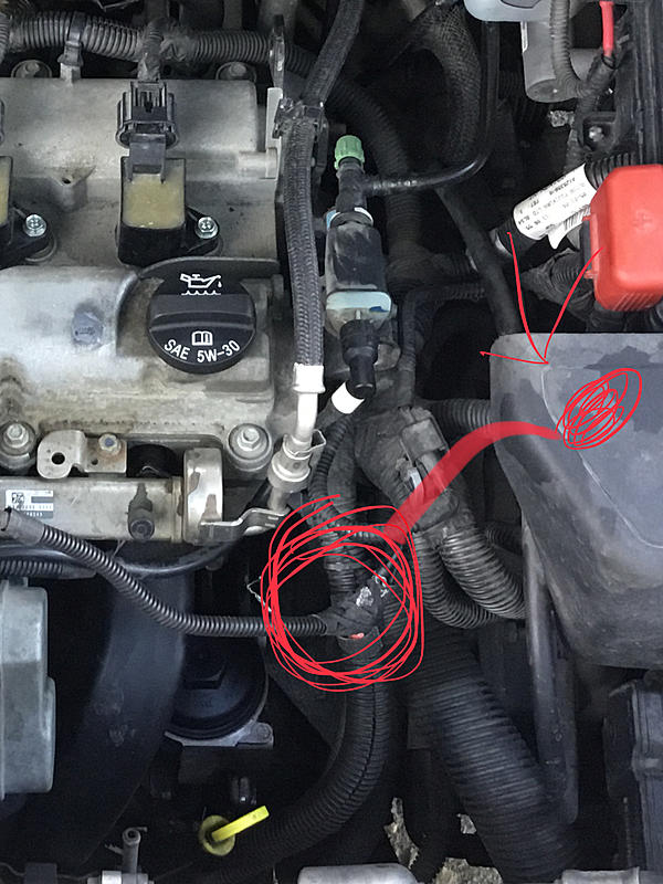

Old 01-10-2018, 11:15 PM
hhrinAK's Avatar
Join Date: 11-14-2017
Location: Juneau, AK
Posts: 12
I like the I because with the cat and res gone it roars and peels like a beast.
i got it direct from gainmpg.com
all you need is some black tape to hide the wire taps
It comes with everything you need and a book with instal info
i use 93 every chance I can but sometimes end up with 91.
this is how mine is hooked up, taped the wires next to the main harness and hid the box under the pcm cover, it recommends putting it on your air box, I assume due to heat but its cold enough here I didn’t think it would matter and I like it hidden.

Old 06-01-2023, 06:02 PM
Dagrocerygettr's Avatar
Join Date: 05-11-2023
Location: Boone nc
Posts: 30
How
Originally Posted by hhrinAK
I hated how bulky the stock box was, I did this half assed job till I get my k&n filter and I make the tubing.
alll in a quest to “make us happy”
how'd u manage to get the filter down there, I tried something similar but my hood struts were hitting the filter
