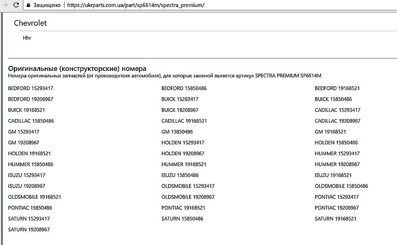

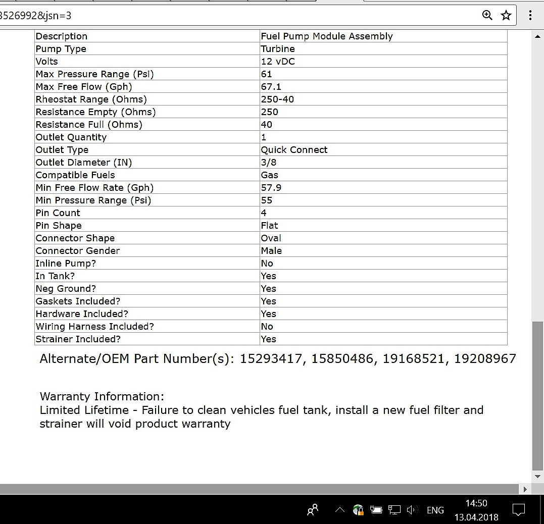

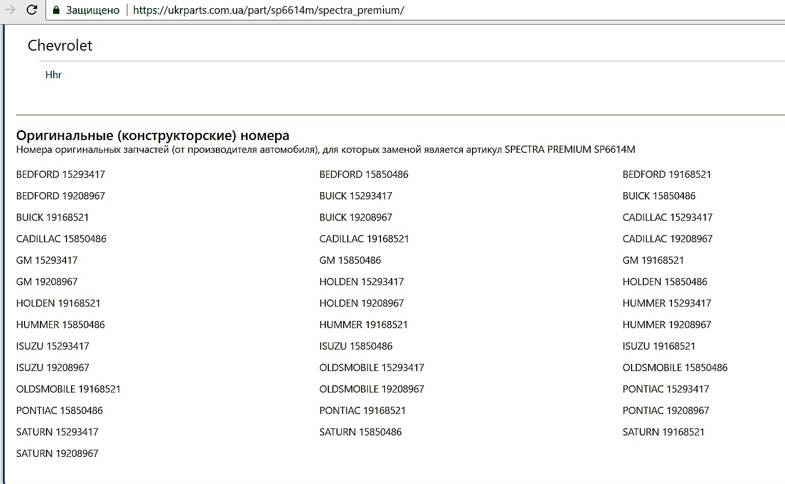

GM P/N 19208967( supersedes 19168521) fits 2006-2008 HHR, no other vehicles listed. Listed as unavailable.
19179948 fits 2009-2011 No other vehicles also unavailable
19207956 fits 2008-2010 (SS) no other vehicles also unavailable
It's right
but, if I understand correctly, this pump can have different OEM numbers. And these numbers for different cars, including Isuzu, Cadillac and Hammer
of course, with equal success I can be mistaken. I'm just a philistine

Some of the differences are the connectors and the color codes and pin positions. I know that on some the gauge wires are reversed.
