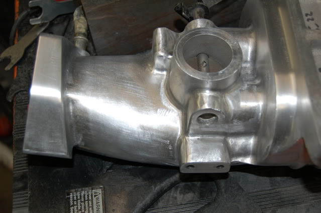

The Huffer, Blower, or Supercharger, whatever you want to call it these days, is just about fully Polished out now, so just a Waiting game at present.

I am basically down to This underside area (the hardest little area never to be seen, but I will know it's been Fully Polished.) that needs to be finished up buffing and polishing on the Supercharger, the rest of it just needs a once over Final Buff, it's looking pretty Sweet.
