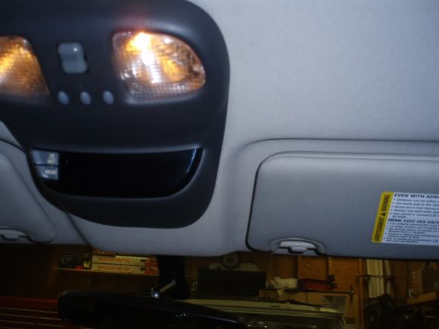

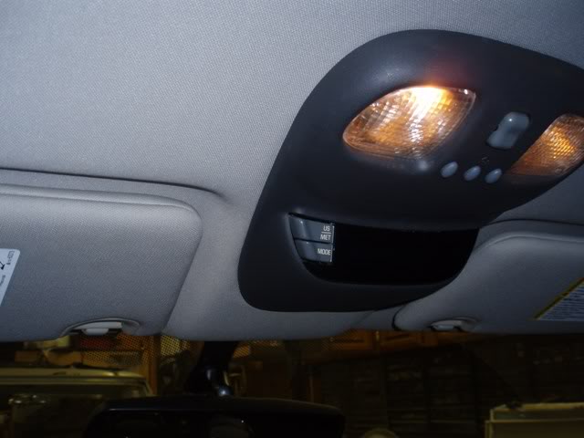

So I am walking around the local Pull-A-Part this weekend and I saw a late model S-10 Blazer sitting there. Roughly a '98-'99 model with a sunroof. Then I saw it....the 'stubby' overhead console. It has two map light, Homelink garage door opener, compass, temp, etc...
I thought to myself... "Self. I bet we can make that work in the P.T. Killer."
So here is my progress so far. Enjoy.

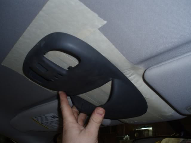

Here is the console I pulled. The extra arm holds the compass sensor:

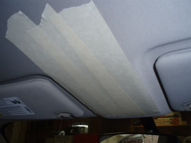

First I covered the headliner with wide masking tape:

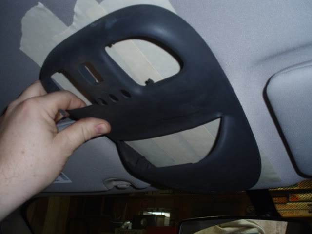

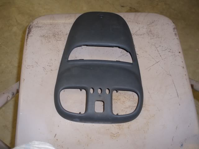

Disassembled console for test fitting:

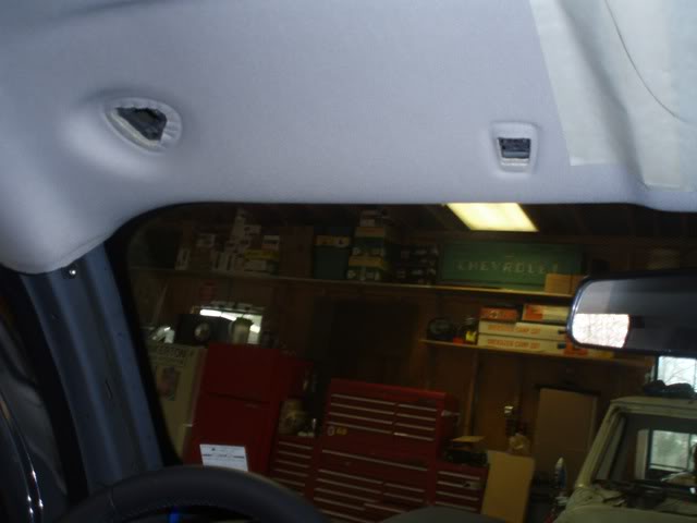

Test fitted...need more tape:

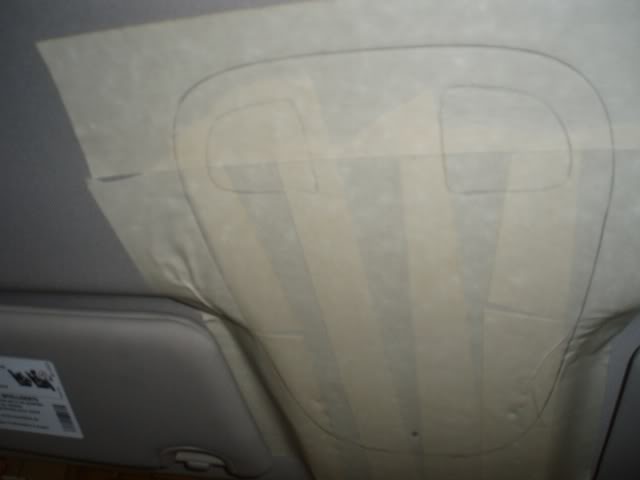

Tape added:
Traced console outline:

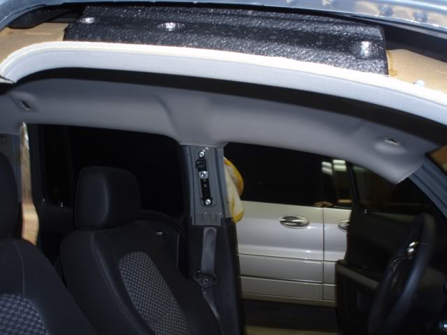

Removed pillar covers, removed visors, etc... and dropped headliner for access:

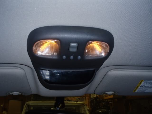

Cut headliner for console wiring and support bracket:
Mounted console using factory bracket from the donor S-10 Blazer
Currently I only have the lights and the Homelink connected. These connections were made at the factory domelight. This allows the maplights to work as a factory dome light (even dims with the others) and as map lights as needed.
I will update this post when I connect the remaining functions.
This will add a compass feature that the car currently does not have.
The second temp sensor will be placed where I have my amps mounted to monitor air temps in the nearly-enclosed space.
