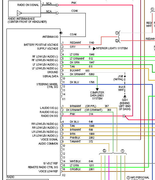

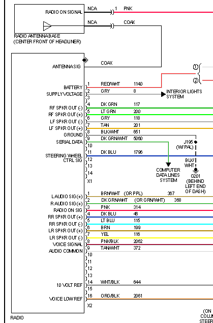

I am not an audio guy, but from what I can tell by the schematics, the difference is the radio outputs a "low level" signal to the amp. I am guessing that means no pre-amp.
The basic radio has "speaker" outputs.
