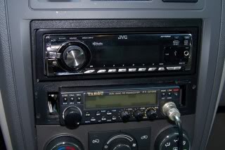

no pics yet and the install aint all that pretty anyway, sure could have used an extra set of hands while using the dremel. I finally installed the radio in the pocket under the stereo, and had a heck of a time finding a good ground under the dash near the fuse panel, finally had to run the ground over to the driver side to get a good grounding point. finally got it all in and now it's not working, so I need to do some trouble shooting on the antenna system as I am not receiving anything not even the weather radio. oh well gotta love projects.

ok here are some pics, it's still a work in progress and still needs some work to make it pretty and all that but this is where I am so far.

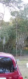

and here is the antenna install
the antenna is over kill for local work but it gives better range when traveling. oh the problem I had not receiving anything turned out to be a short in the new antenna coax that came with the mount I just bought.
