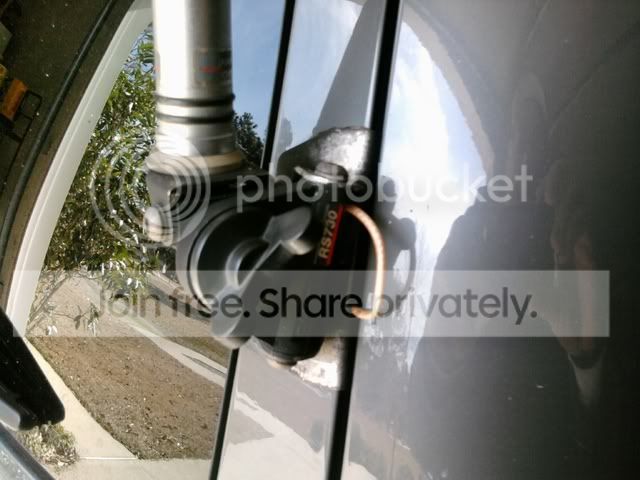

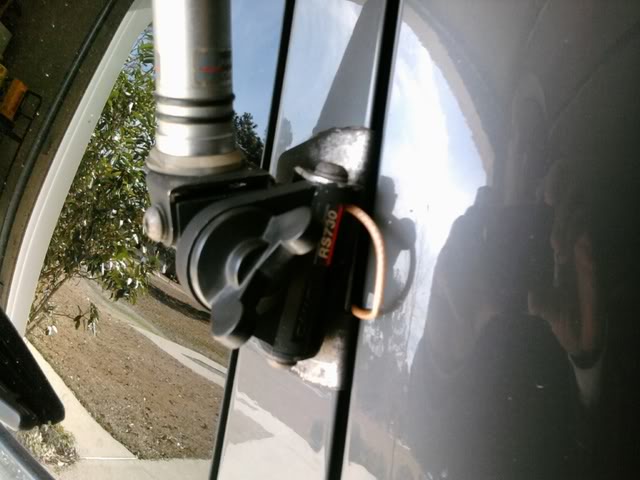

Eric...Click on the camera to go to my uploaded photos for some shots of the mount. Not sure which mount this is as I think I have both a Diamond and Comet. They look about the same. If you get one be sure to get the one with the cable and connector. They utilize the very small coax to get though the rubber seal around doors or hatch. Also if you're not aware, there is a group on Yahoo for the ATAS antenna. Lots of good info, installation photos and so on. Learned how to take mine apart after I twisted off one of the screws that holds the stinger in the top.

Found three pictures, only one with an antenna. Is this it?

Ooops, sorry. Put them in Photobucket and forgot to bring the over. More there now.

What is the part number for this mount?
Looks like RS730? Is that correct?
Who is the manufacturer?

Looks like a Comet mount..
