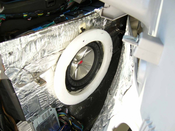

10-4, Maybe just maybe he'll take a close up picture through the grill so I can see the placement.

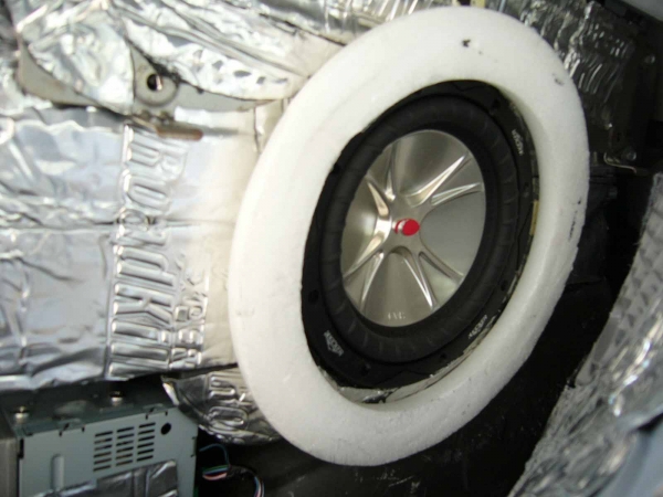

Old May 20, 2007 | 04:52 PM
Navyflyer11's Avatar
Joined: 02-23-2006
Posts: 629
From: Oklahoma
Here is a couple of pics of the foam ring I use for a spacer.
