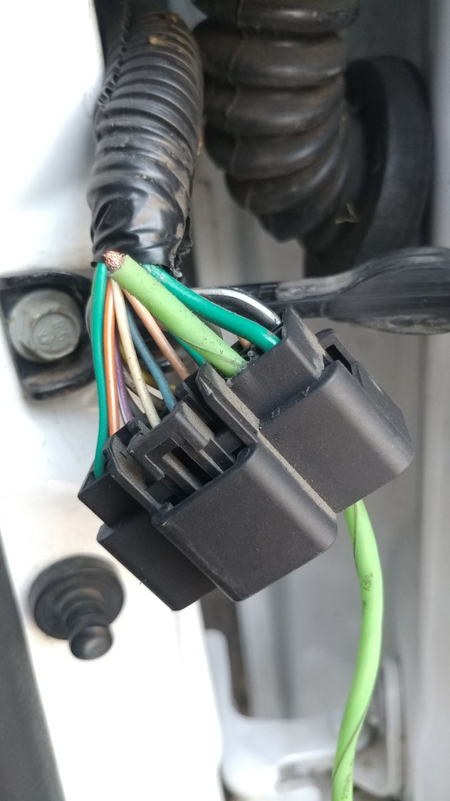

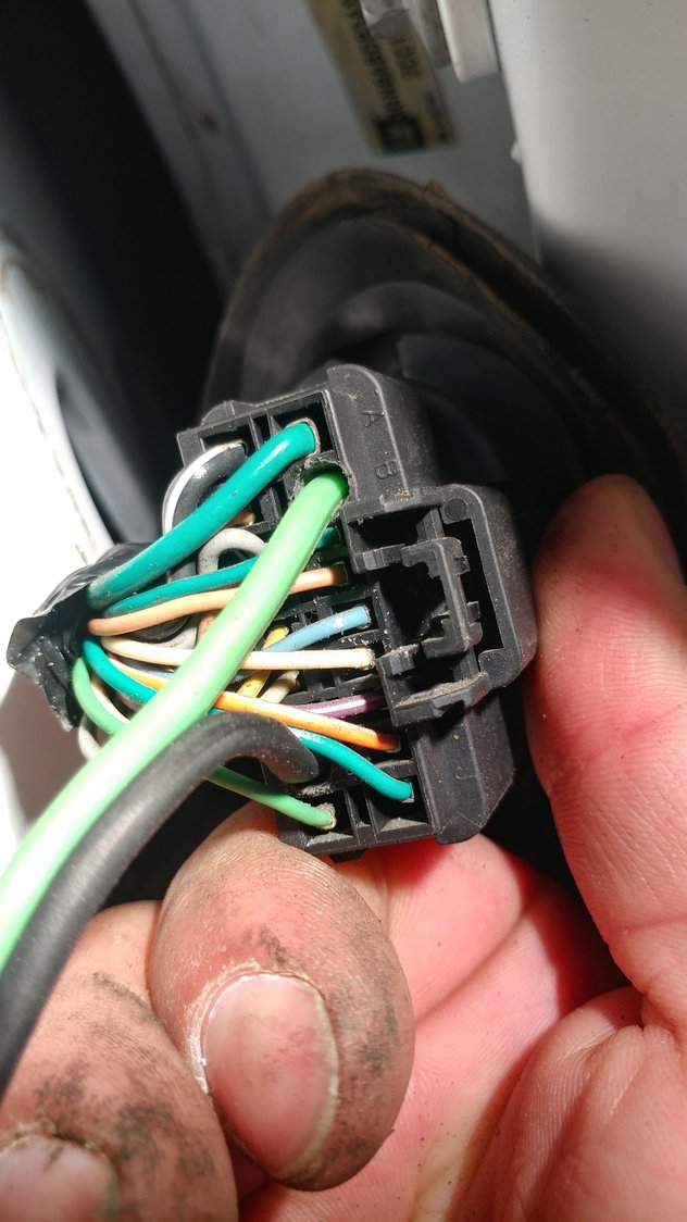

I made some progress. I think I'll be able to use the 2 empty spots for 16awg wire
question is: is the driver side the same? I hope so.

Passenger side done!

Don’t forget, 2 of those wires are the existing speaker wires.

A bit of a hack job. I was confident in my ability though. And it worked.
Driver side was such a PITA.
