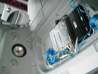

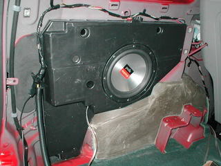

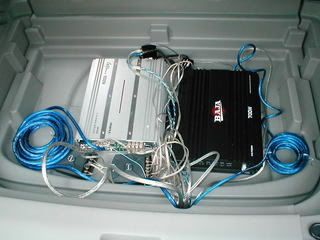

well, the stereo is in for the most part...............still have to eliminate the whine and get the steering sheel controls functional ..............but it sounds GREAT...........i had to hustle to get it functional over the weekend because this morning i drove from Maryland to Connecticut , spent 2 hours trying to cross the bridge into new york.....and i also took a couple back roads for a travel time of 8 hours
and the HHR is WAY more comfortible than 99 subaru legacy that i upgraded from.......

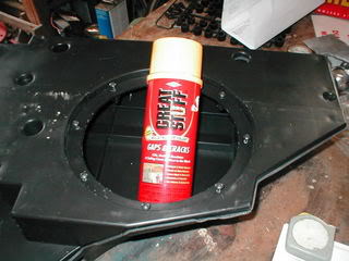

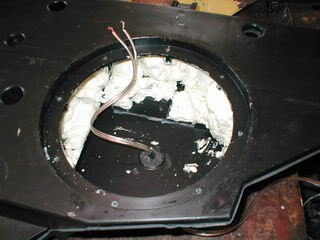

the factory sub box seemed kinda hollow, so i gave it a little mass and internal sound deadening by adding a can of expanding foam
the wires didn't get to stay where they are above ...BEACUSE the Polk sub was TOO deep.................so i took a heat gun to the back of the box and formed a deeper pocket
of course that wasn't enough.......SO, i had to cut a spacer out of some plasitic i had laying around the shop, it is the black ring, the white ring is a gasket that came with the speaker

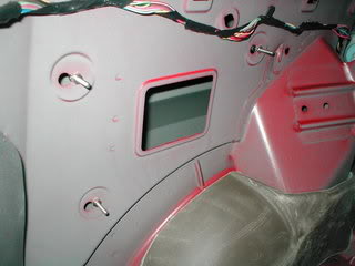

of course now that that is all together, i discover that i don't have the studs in the car that are required for mounting the box.................so i make three of these.......there is one more mount down at the bottom of the box, but
it didn't seem necessary (reads, it was more troubel than it was worth, i hope)
