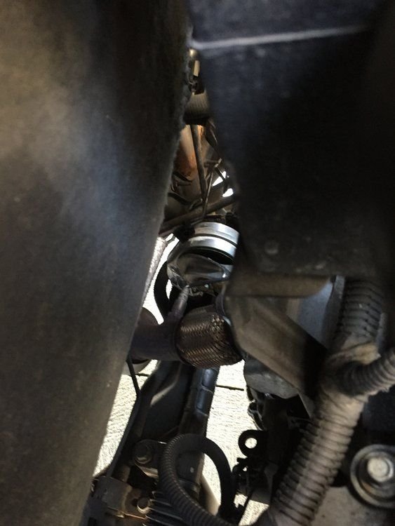

From the top passenger side you can see the rear transmission mount
From the top driver’s side , there it is

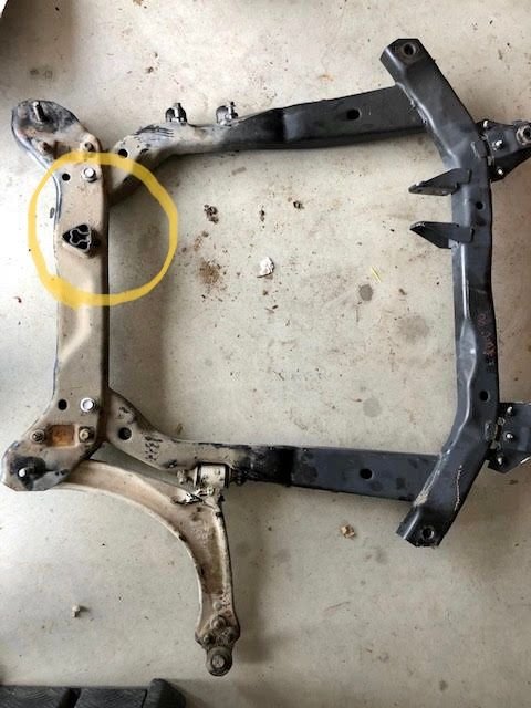

Here’s a photo showing the triangle with the cradle out of the car for clarity, you don’t have to remove the cradle to install the spacer

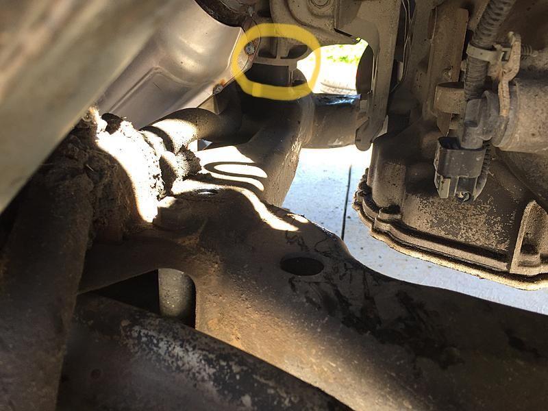

Here’s more
This is from the passenger side with the steering rack removed to see the rear transmission mount on the cradle bracket, there in that circle highlighted

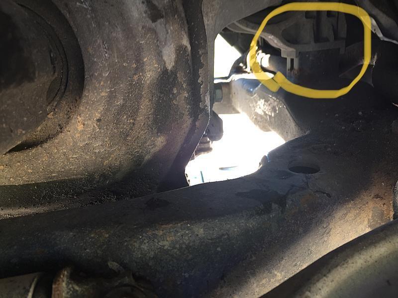

And from the driver’s side, that’s where you install the spacer Note: you don’t have to remove the steering rack, I just found these photos in my library.
