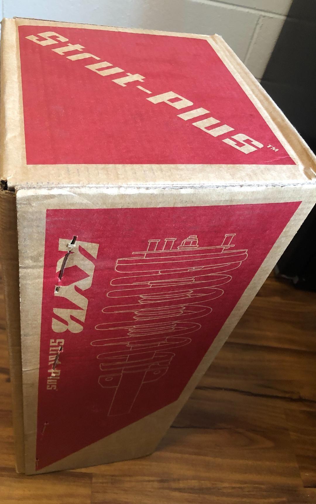

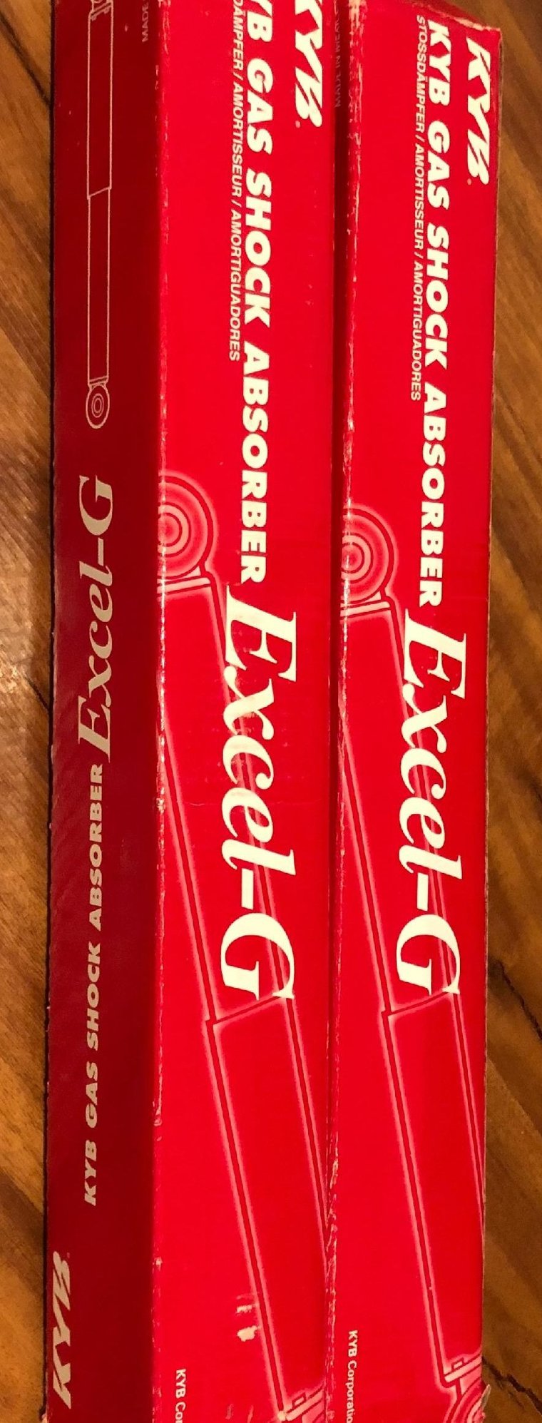

Parts All Ready to go.... Sunday is the day... prayers for a solution

The last time I bought struts for and HHR LS, KYB had only bare struts and no “loaded” option. Good to see they now do in the “Strut-Plus.”
When it’s in good shape I would rather keep the OEM spring, though.
If I want to keep the spring and replace the strut and EVERYTHING else, what do I need besides the strut?
