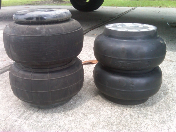

well... still waiting on the easy street kit. They said it'll be worth the wait, cus the new kit will go higher and lower than the previous design. In the mean time, i figured i would upgrade my rear bags, and prep my tank and compressor setup. i decided to switch from my cheap ass Chassis Tech bags for some Slam Specialties RE6's. The new bags are twice as expensive, but the ride is much smoother and i don't have to be lifted so high for a descent ride.

How do you like the slams compared to the other bags? The nice thing about the Slam Specialties bags too is that they don't balloon out when you inflate them - can fit them in tighter spaces...

i love the slams, the ride is much smoother. and yeah, the chassis tech bags ballooned out and rubbed on the spring cup. Slam Specialties are just a better bag... period. my HHR was my first attempt at an air ride setup, and i've learned quite a bit, mostly what not to do. and well, you do get what you pay for. it's better to spend more money up front on the right parts, instead of getting cheap parts and having to upgrade later on. i've ended up paying for two separate setups for the rear, and am still waiting on the front to be finished. oh, and the compressors aren't that bad, the road noise and my exhaust drown out the sound, and i've got enough dynamat to get rid on the vibrations.
