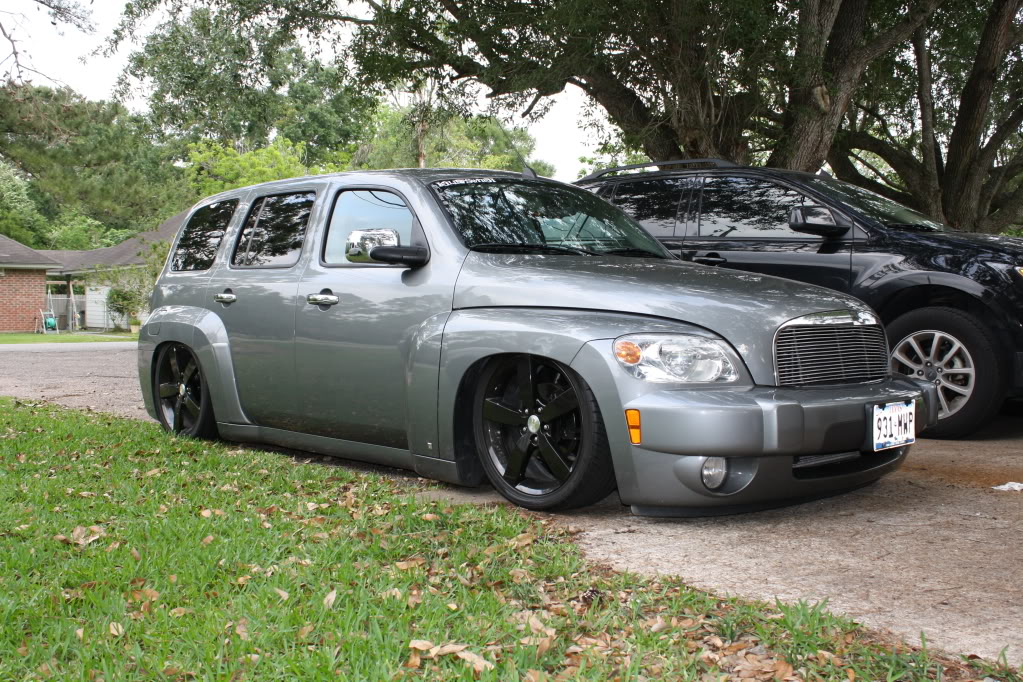

here are some pics of how it looks now that the back is lower. something ruined the image quality though.
down

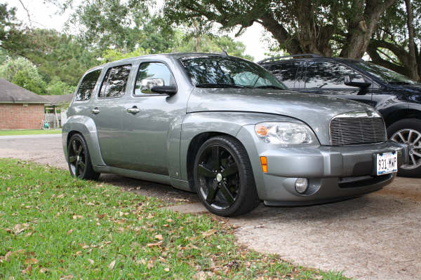

up

first pic is now desktop background.Thanx and sexier ride by the day

wow . it looks great...i'm jealous...........is 2nd pic all the way up???

yeah, i'm runnin about 40 psi right now, its kinda slow gettin up ( 4 sec. ), but im using less nitrogen that way. with no shocks, runnin 160 psi, and toggling the switch, i was hoppin the rear, but that drained my bottle real quick ( hella fun though )
