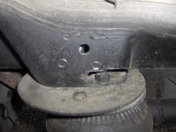

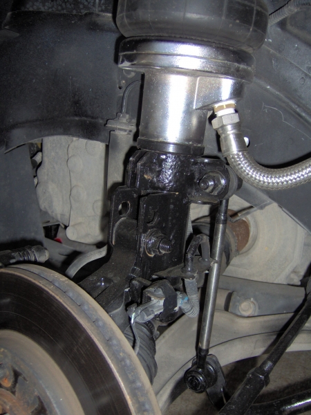

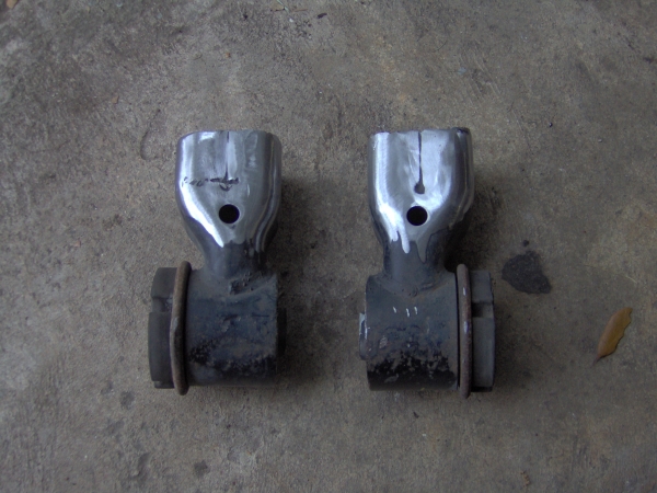

here is a pic of how i got nuts on the top of the bag to mount it. its ugly but its about to get cut out to go lower. and also the new front struts. i made the botton clamp on instead of welding, which i think is what ruined the first set.

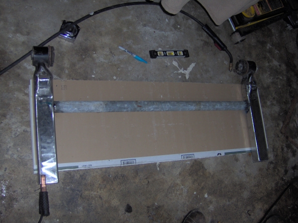

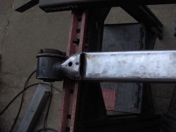

here is some of what i have done. i am using 2x3x3/16 square tubing to rebuild the rear end. the plan is to get about 2-3" lower and center the wheel.
before
reused the stock bushings
