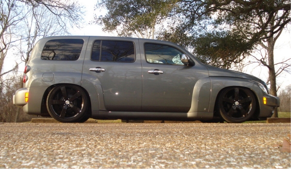

this shows how far off the ground it is. looks way lower in person. also in this pic the front sits about 2" higher cause i have some stuff welded on there to drag, which im about to cut off.

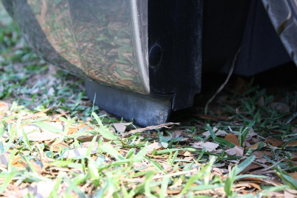

Its hard to tell but the frame sits about ¼” higher than the ground (before drag blocks)

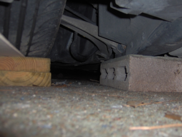

Also look at this picture, the emissions “canister” hangs low too. i gotta figure out how and where to move mine to lay out the back

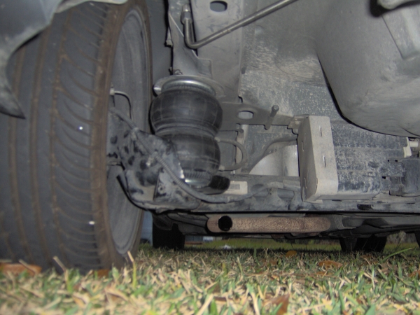

ok so the front is fixed for now.
