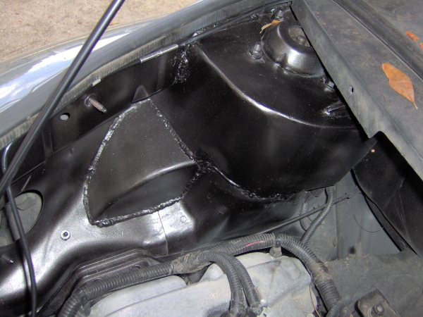

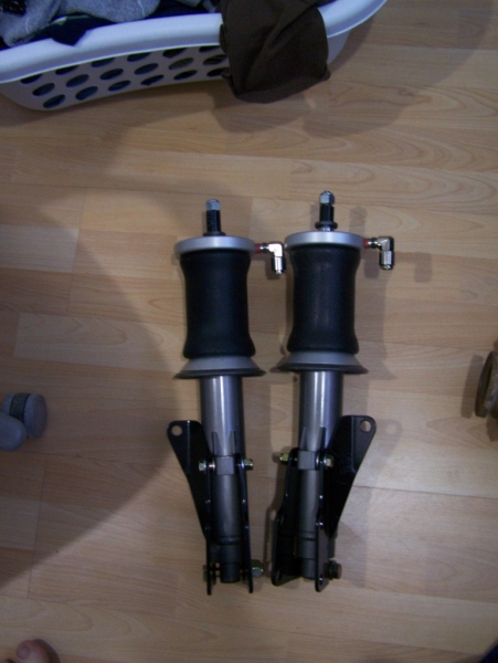

here is what the easy street kit looks like. i have been talking to a guy who put this on a saturn ion. im waiting to hear back on how it rides. it only tucks about an inch of tire but gets about 4-5" of lift. i dont really like that they use "sleeve" bags

forgot to post this pic. i got one side done. some people had said it looked ugly so here is what it was supposed to look like

Thumbs up Much gooder
[QUOTE=garagebuilt;371001]forgot to post this pic. i got one side done. some people had said it looked ugly so here is what it was supposed to look like
dat looks much gooder . so , you mean that that kit will only lower the front 1 inch???
