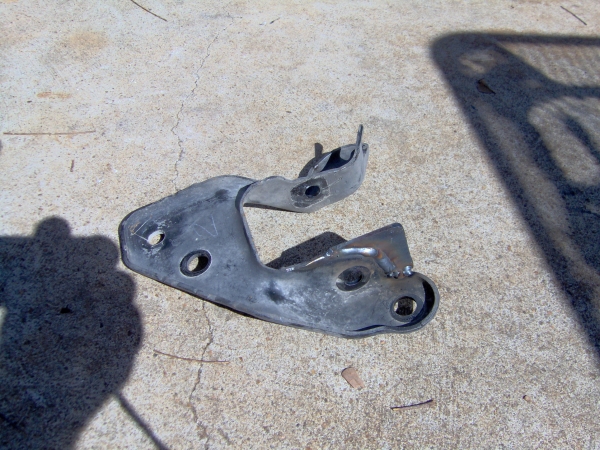

i had to roll the rear fenders in about 1/2" on each side. take some tin snips and make a cut every inch then tape up the outside of the fender so you don't scratch it. hold a block of wood on the outside and beat where you cut with a hammer. also did you notice how far forward the wheel ends up. thats the curse of a 2link. i had to add an inch to mine.

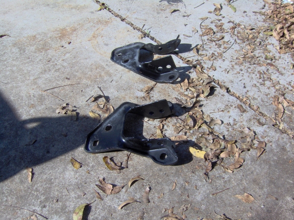

here are some pics of the hangers. this is how i made the 2link longer.
