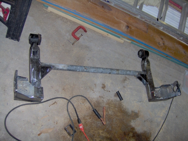

ok i thought you wanted it lower not just quiet. yea then you probably have done all you can do. i wish these were made like cars were 40 years ago. its scary how thin the metal is. the 3/16 square tubing im using is almost twice as thick as the stock stuff

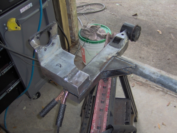

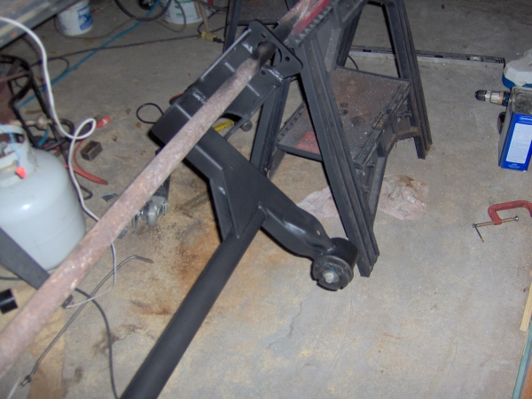

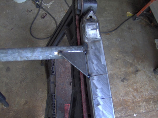

here are some more pics of what i have done. i forgot to take one after i tacked all the pieces together. I test fit it and everything looks good. got about 1.5" without trimming anything in the fender. just needs to be gusseted and then paint.
before
after. still can go lower

Since you've built your own new rear axle assembly, why not make brackets to put rear discs on also would sure look better than drums through your thin-spoked wheels

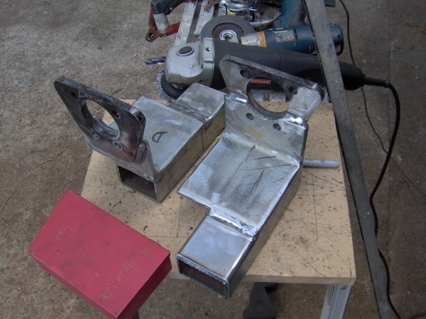

here are some more pics.

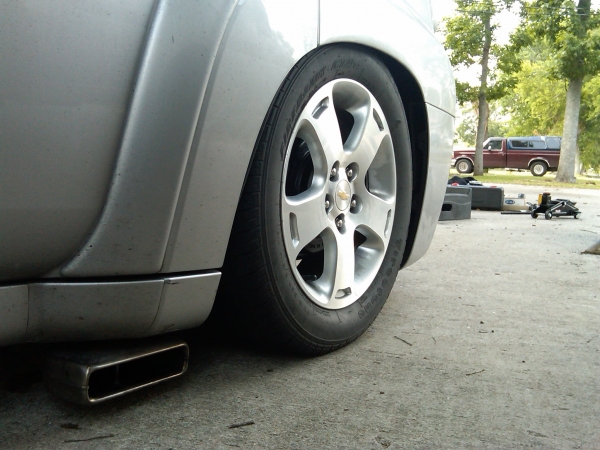

FINALLY!!! got the rear bagged. no time to post any more, gotta go play
