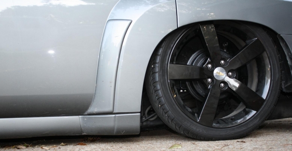

the back isnt all the way up in that pic but the front is. the back will go up almost 2" more. then layed out it should be close to setting the bumper on the ground once i tub it. i got way more stroke moving the bag forward.
i leave my regulator at 120psi. the back comes up pretty fast but the front is slow.the front rides good at 90-100 psi and the back i have no idea what psi but it rides the best with the tire even with the fender

got the rear a little lower

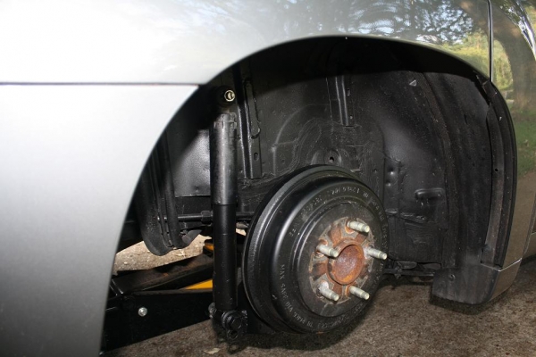

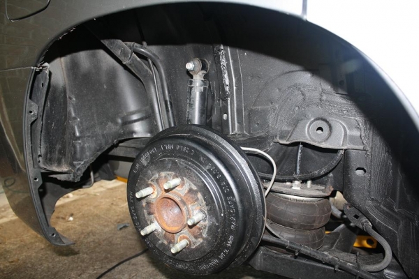

ah, you moved the bag toward the front. great idea ( more stroke ). you mentioned the shock relocated to the rear wasn't quite workin for ya, it still bottoming out in its current location, or you fixed that already? and what is the upper shock bolted through? did you add reinforcement? All in all, its a great setup, maybe one day mine will be up to par with yours. Keep it up... or down

i do get more stroke with the bag closer to the pivot point, but mostly i did it to get a softer ride. the shock is fixed in that pic. i moved it up 2.5" and it doesnt stick out as far. before it would actually rub the insside of the rim when i lifted it too high. i just took the plastic out on the inside of the car and drilled holes. on some allthread i welded on a nut and big washer. thats on the inside. since the shock bolts up tight to the sheetmetal on the inner fender thats all the reinforcement you need. my stroke is still limited by the shock but only a little. now the tires sit on the inner fender when layed out.
