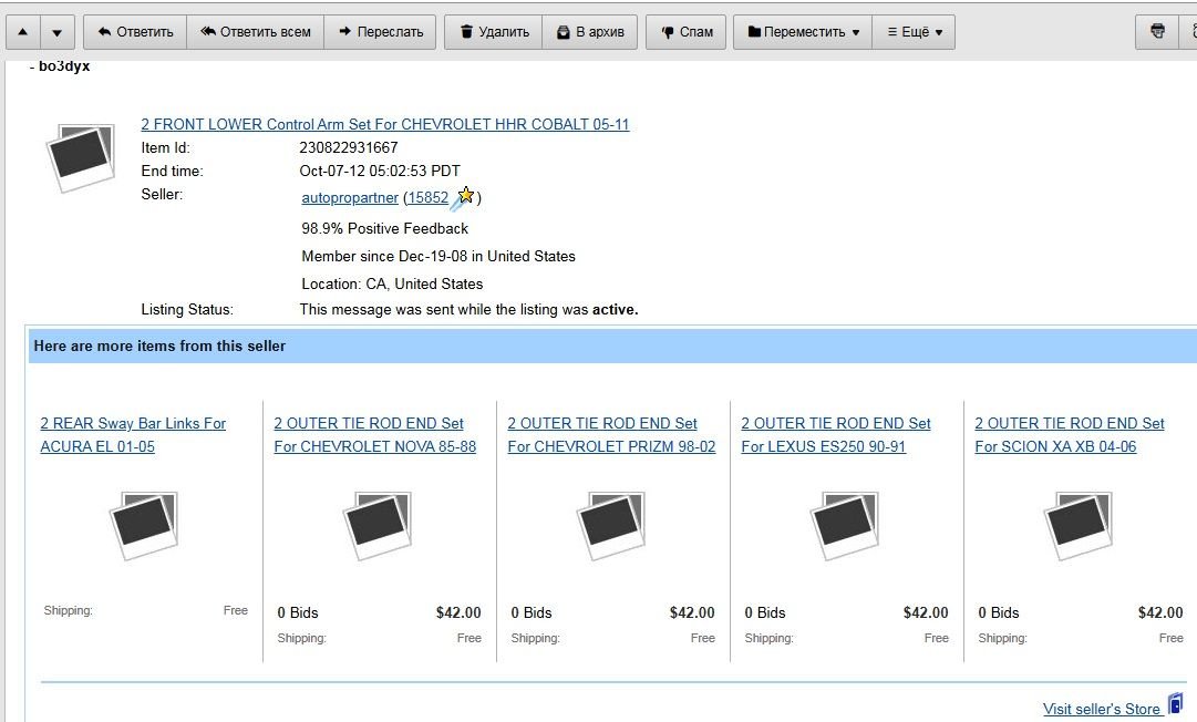

I did it once. I was looking for a rear Control Arm Bushings. And suddenly I see two Control Arms in the kit for $ 110, shipping from the USA to Russia is free.
Cool deal! Two bushings cost about $ 20 + shipping $ 40, and that = $ 60. I will add another 50 and get the American alloy Control Arms assembled with all the Bushings and balls.
But my cargo arrived not from the USA, but from Taiwan. And after the installation in the suspension, the Bushings lived no more than a year. I still had to re-acquire the rear bushings, and the little bushings too. Ball joints are still alive, but I'm alive in constant fear.
In our area there is a saying: "avaricious pays twice."
Since then, I am biased against Taiwanese parts. And no matter how much the "great parts" is said to me, I do not believe and do not want to check.
Now I tried to find this seller to warn you against purchases.
But it looks like he got broke or fled.
