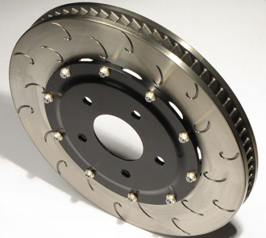

Originally Posted by solman98
They are what's classified as "floating" rotors. Hub centric isn't an issue. THe wheel itself holds the rotor in place.
Although I agree the wheel holds the rotor in place..
Our rotors & SS are "Fixed 1 piece rotors"..
"Floating Rotors" are quite different, they are actually a 2 piece floating rotor...That is bolted together thru islolators to allow the friction surface to align as needed..
But this mod I can see doing should the need arise....

This is a 2-Piece rotor assembly from Wilwood, the center section or "hat" is separate from the friction surface.
As sleeper stated this design allows for some movement during braking that allows for self-alignment of the friction surface.
If you watch NASCAR you're probably familiar with cars smacking the wall and "breaking a rotor", its actually just the outer friction surface that breaks.
