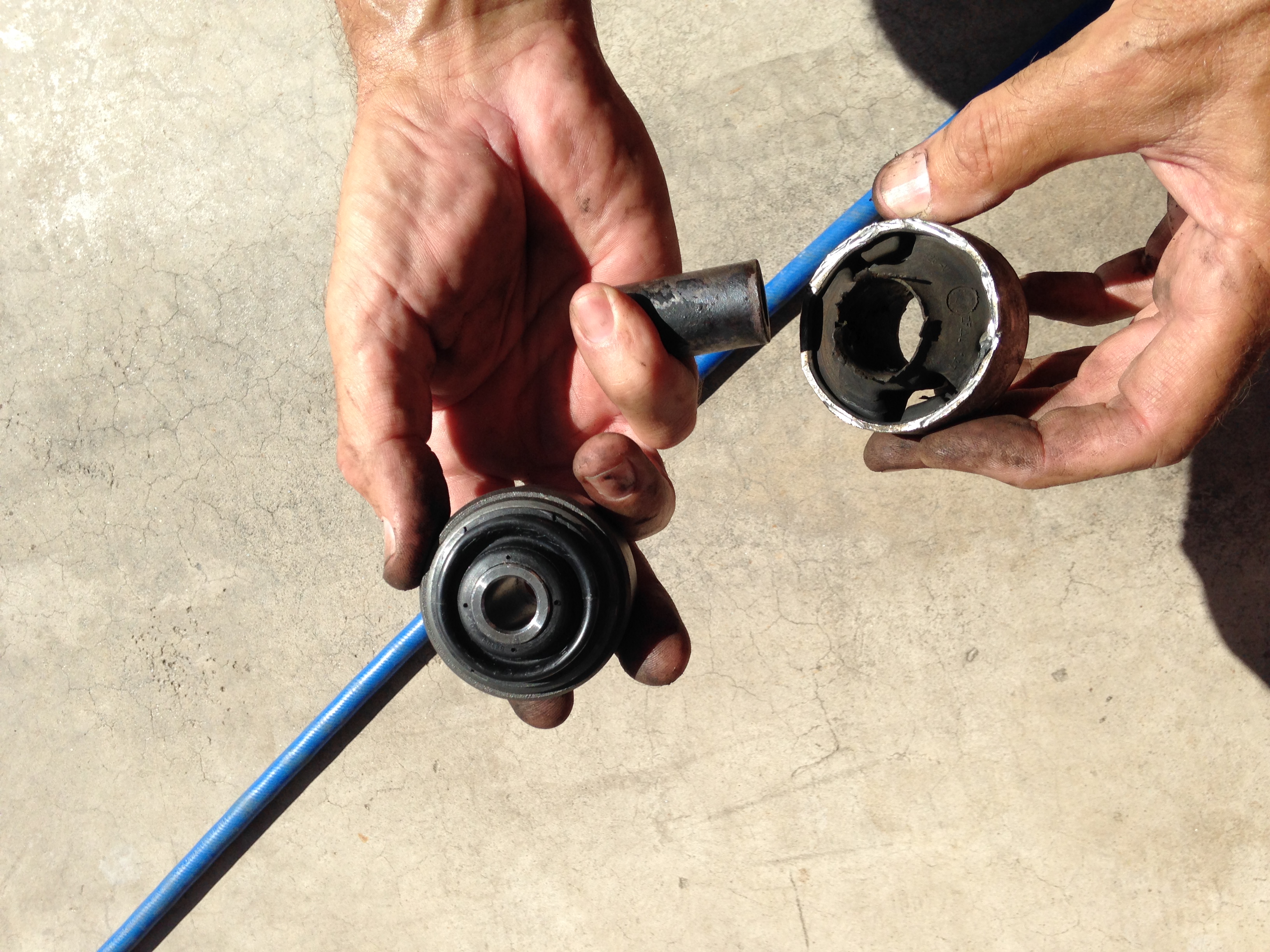

Check your lower control arm bushings! If they are toast you'll get the shakes!
