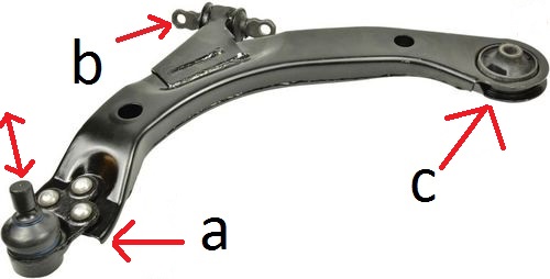

Posts: 11,721
If you think about it, then it's a bad design. As the suspension travels up and down (a), then it will pivot correctly in the front bushing (b).
The problem is the rear bushing (c). Since it's 90 degrees offset from (b), then it doesn't rotate like a normal bushing. It just twists side to side and flexes the rubber until it wears out.
Wow. I've got too much time on my hands.

Old Jan 29, 2017 | 11:39 AM
Posts: 26,533
I never noticed; that's why the cut outs are where they are!
