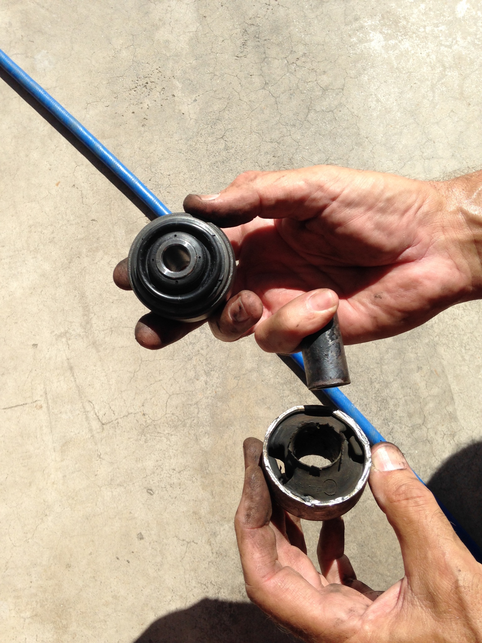

It's not the mileage, it's the age
The one on the right had 60,000 miles and three years of service and even my front end guy said it looked fine, but take it apart and I found this two piece mess!
The Moog bushing on the left is what I pressed into replace the OEM (2nd set) and its been fine ever since August 4,2015.

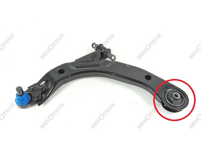

It's the large round bushing on the lower control arm, the bolt goes vertically through it into the cradle and threads into the nut captured in the body, just below the firewall. This photo is of a Saturn but the same setup as an HHR
Here a thread about it from back in 2012, There's a picture in post #2
This is a Cobalt LCA with the bushing circled in red.
Don't use these stamped steel arms on your HHR
https://www.chevyhhr.net/forums/brak...bushing-39002/

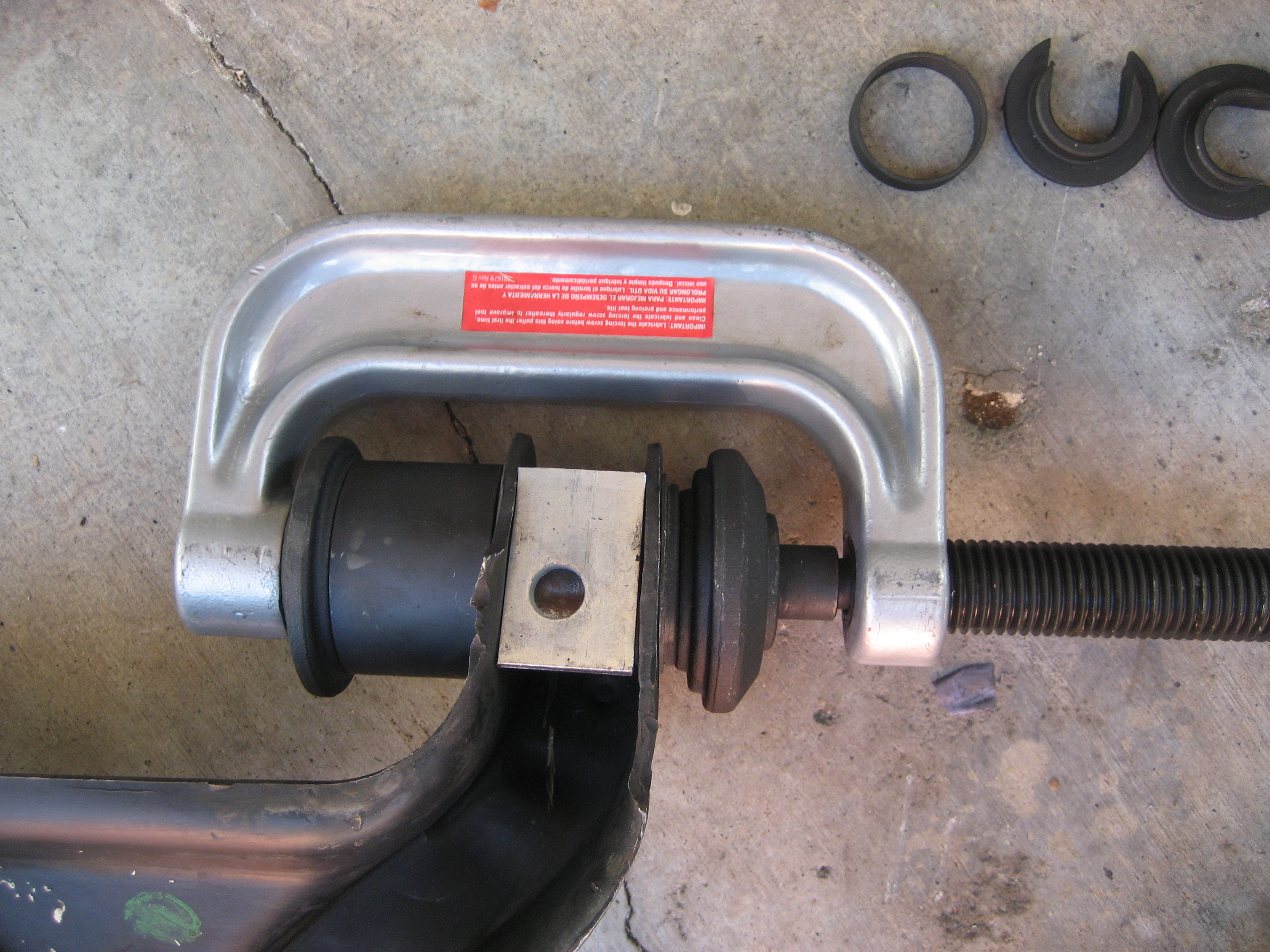

Like in the picture, I've pressed mine out with a ball joint c-clamp , I've also placed the lca over an old brake disc, and driven the bushing out with an 8 lb mini sledgehammer, and then once loose used my air chisel to finish the job.
