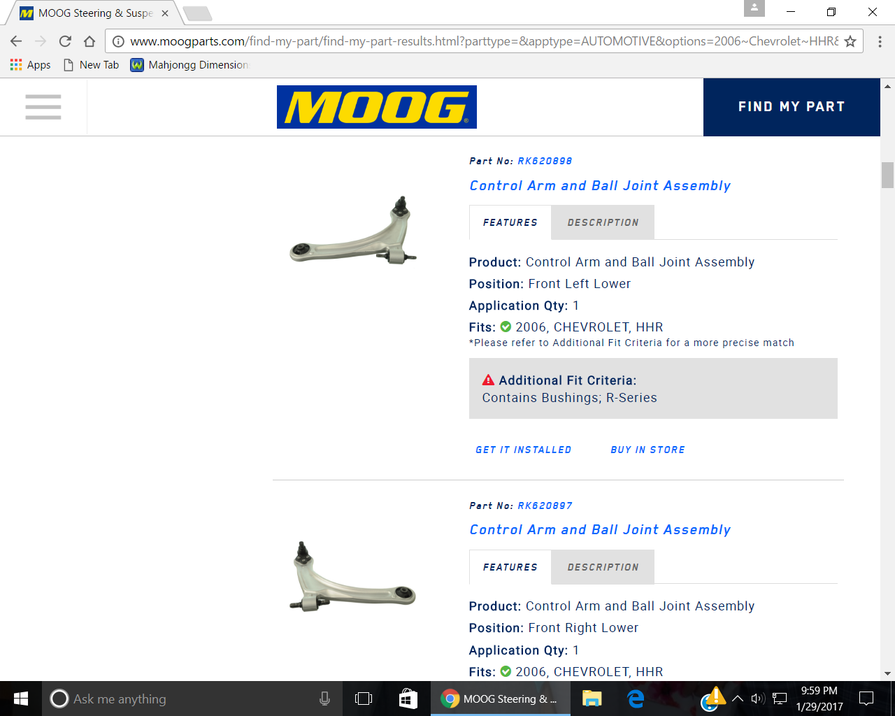

So the Moog part number RK620897 and RK620898 are the correct full control arm assemblies needed for the hhr? Give a quick copy and paste into Amazon to see them. I have them saved to my shopping list pending an answer. All my bushings are still original after 200K miles and I have noticed fast clunk sounds when backing out of my garage. Also some highway shimmy that may be related to these parts as well. Will one of ye ol experts fact check part numbers and get back to me?
Old Jan 29, 2017 | 10:02 PM
Posts: 11,721
That appears to be the correct part #'s. But, I'm pretty sure those come with the standard rubber bushing and not the improved Problem Solver ones.

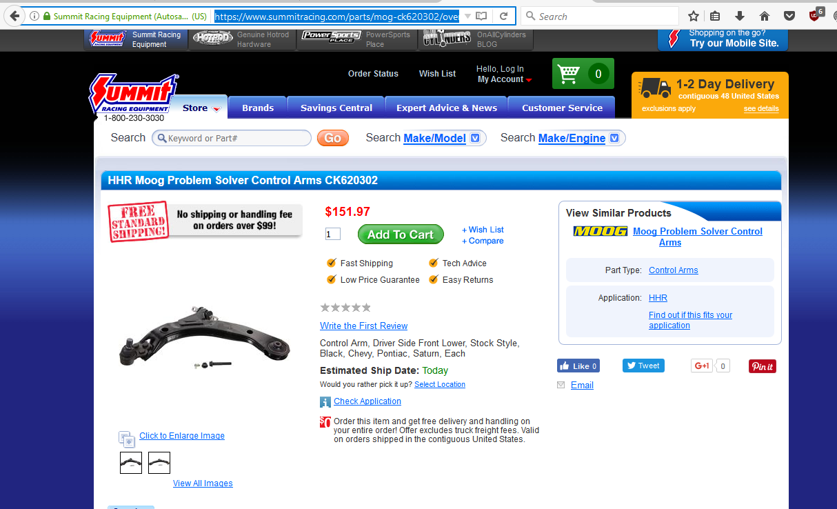

They may not be available in cast aluminum
https://www.summitracing.com/parts/m...view/model/hhr

Old Jan 30, 2017 | 09:47 AM
  #29
Posts: 40,083
Those in the Summit add are stamped steel and do not have the ball bushings , just good old rubber!
Old Jan 30, 2017 | 09:53 AM
  #30
Posts: 11,721
That may not be true. I copied this from the Summit ad description.
(But, they would still be the wrong stamped steel unit )
"Moog Problem Solver control arms incorporate proven design and engineering features to provide a comfortable ride. They're manufactured from high-quality materials and have a full ball metal stud that provides 360 degrees of smooth, consistent, rotational movement—resulting in more responsive steering"
Not sure if that's the description for the ball joint, rear bushing or both.
