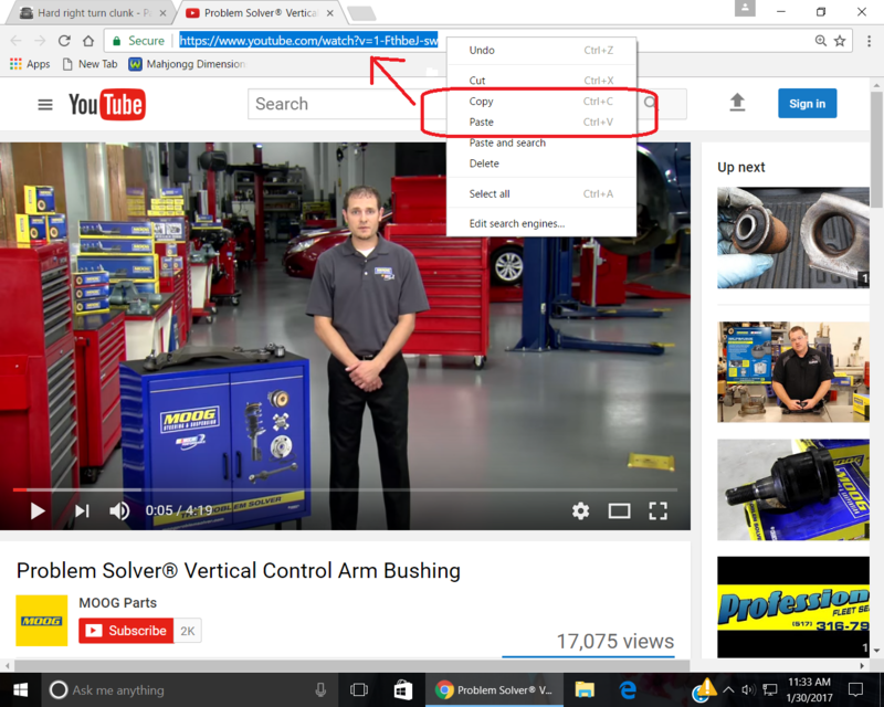

Old Jan 30, 2017 | 11:32 AM
  #33
Posts: 11,721
Just pull up the video you want, and copy the www address it has. Then just paste it into your post.

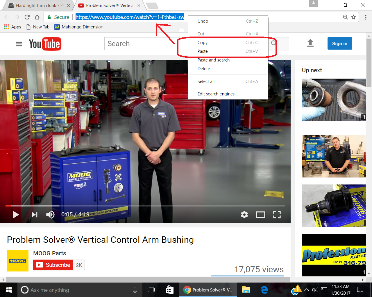

Attachment 20790
Dummy me. That I know how to do. My brain is on tilt, thought it was just the video and not the whole page.
