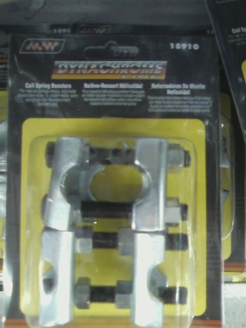

another option....
try some local parts stores for some spring clamps. they're simply two bolts on and a two fittings that either compress or expand the coil. pretty simple, I know that checkers sells them in packs of 2 for aroud 7 bucks. use about 3 on one spring, evenly space then just turn the bolts to your compression liking, lock the bolts together and its done. it just clamps two coils togeather. work pretty good for what they are. i'll try to run by checkers tomorrow to snap a pic. so you can keep your stock springs and stock ride.

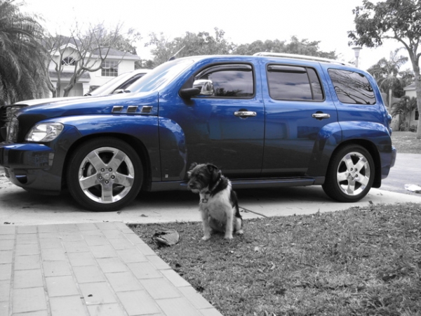

Originally Posted by tahenke
What is the difference between gen1 and gen2?. I am either more lost or more educated now. I can't figure out which lol
1st gen vs 2 gen Goldlines..........
Casper is riding on 1st gen GLs..........
Dory is riding on 2nd gen GLs...........

The spring clamps
Here are the spring clamps i had talked about.
hope this helps
