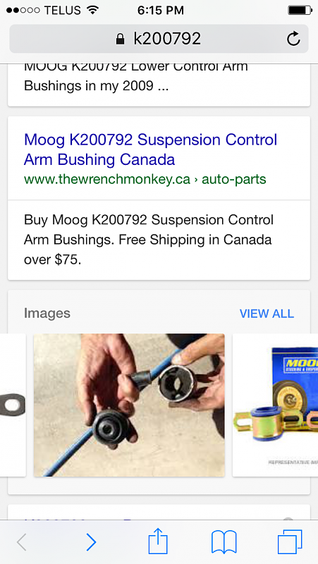

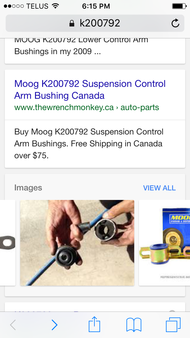

If it's just a matter of replacing the rear LCA bushings, the the Moog K200792 problem solvers are the ticket, drive out the old mushy rubber bushings and press in these babies! Very cool that when Googled the bushings this page showed up!!
