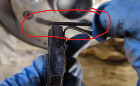

If you installed the "skreetchers" correctly tell her to report the "whirring" sound when the brakes are applied, sometimes even when not applied. If the groove in the pads is gone the pads are worn out, most people just let it go until they get really thin. The groove has a function, it collects the dust.
Never "top off" the reservoir. The fluid level indicates brake wear. A half full reservoir means you better look at the pads, quickly.
The "skreetcher" The belong on the inner pad.

skreetchers are useless if ignored
Where Should The Brake Pad Wear Sensor Go? - YouTube
I left them off, when I had trouble getting the pads to slide in the new hardware. They didn't want to stay clipped in, unlike on A/C Delco pads which I normally prefer to use., and I didn't want to chance their getting loose, jamming in the caliper bracket (I've had that happen on my old S-10). I bought a cheap all-in-one set in a hurry, this time, trying to get it done overnight for her trip, but failed. That's why I'm going to visually inspect them, and/or replace the pads before they're worn down, with A/C Delco pads (with the noisy parts!).
