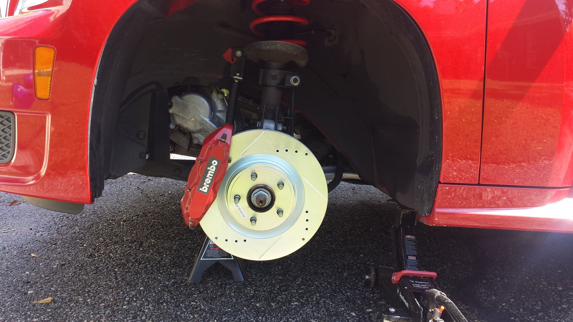

Posts: 11,721
The drilled and slotted rotors do look good. Especially with the big Brembo rotors.
