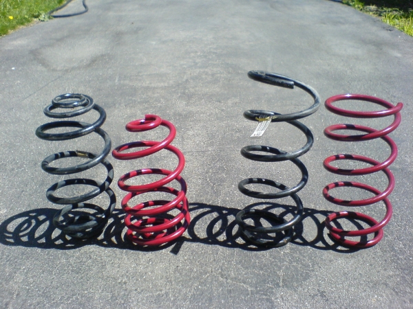

Heres pics of the canuck springs compared to the stock LS ones. It seems the front lowered perfect, but the rear not so much.
