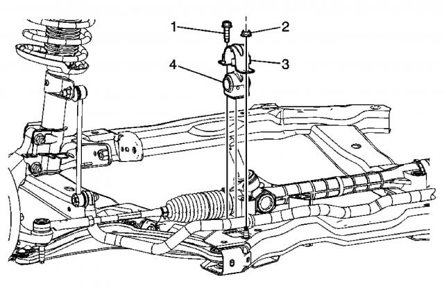

Posts: 11,721
A little visual help.
Name:  FRONT SUSPENSION.jpg

  #37
Frenchy42's Avatar
Joined: 12-06-2013
Posts: 540
From: Everett, Wa
Thanks George, I was able to find them with a little help from youtube. The nut labeled as #2 is a huge PITA to get to...
Old Sep 4, 2014 | 10:37 AM
  #38
Posts: 40,088
I used a 10 mm socket from the bottom and a 15 mm open end wrench on the nut on top.
