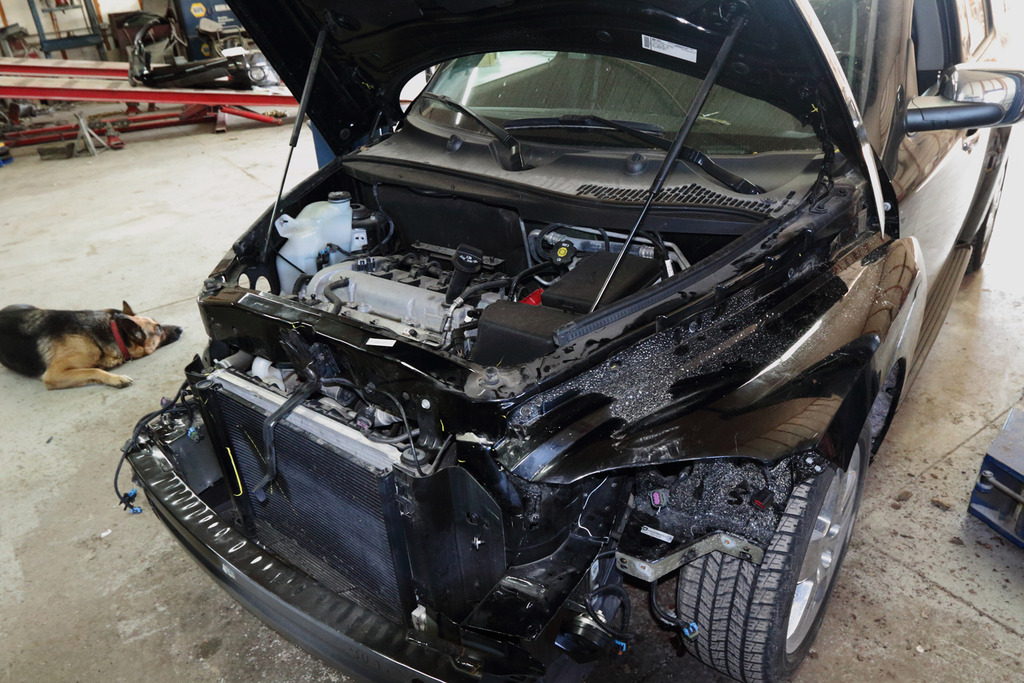

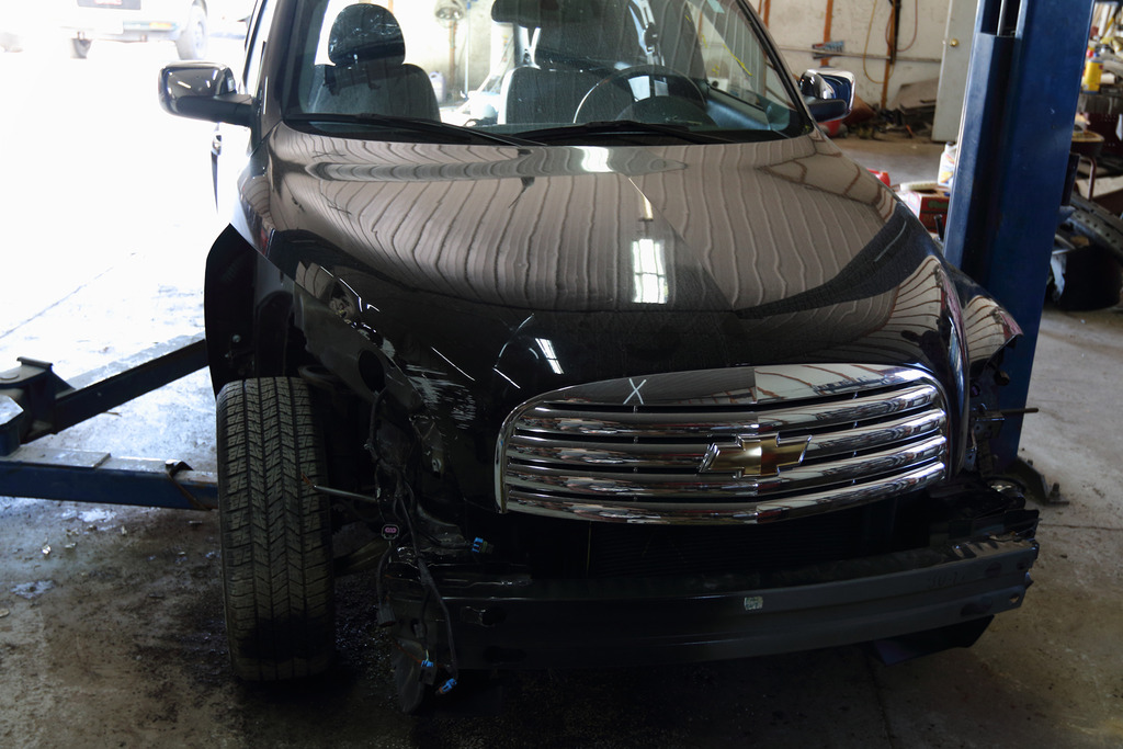

Well I just last week when I decided I was going to own this 2009 found on an insurance sight. With 27,400 actual, one owner miles, and more options than I was looking for. After running the Vin, and seeing what we thought was a minor hit. I got it for 1/2 the price I was willing to go at auction. That really scared me,,, why so cheap??

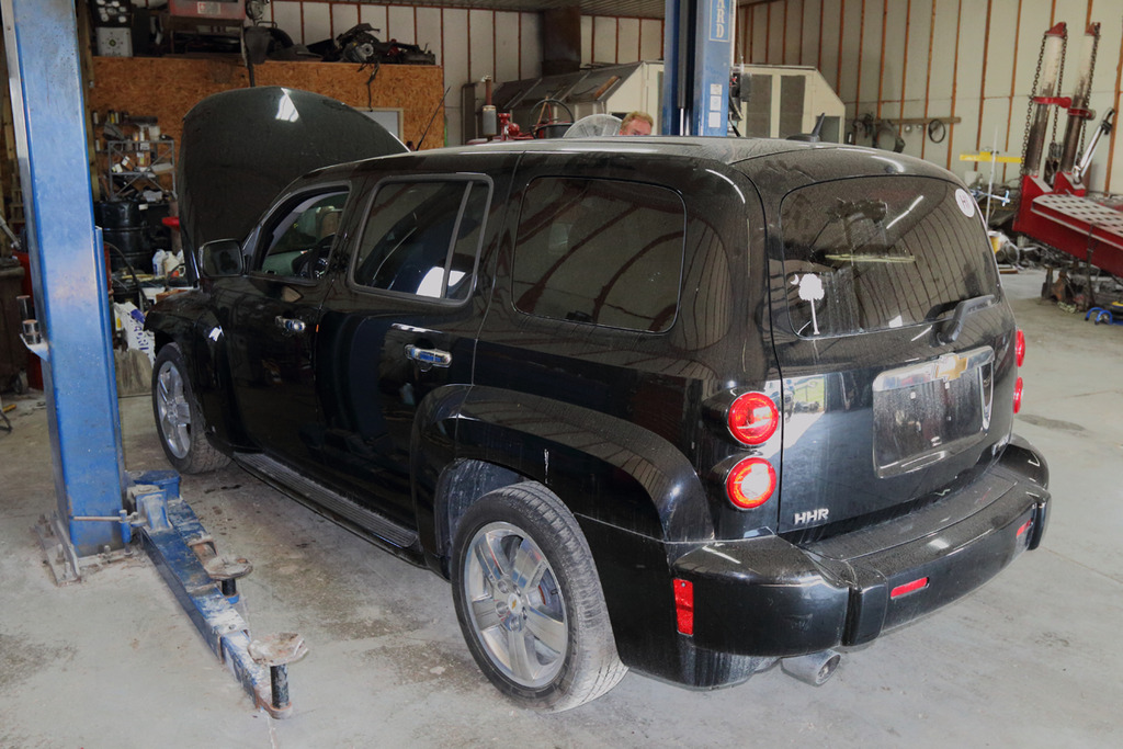

Well it was finally delivered this morning,,, within one hour, the drivers fender was back on, the front bumper support was pulled back into position,,, and when trying to close the hood,,,, it lined up perfect and function as new!

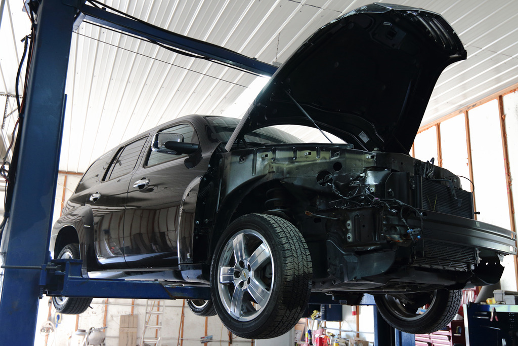

When I found this, I had my buddy who has the shop and license to buy, and we both agreed on what it looked like we would need to get it right.
2 fenders--front bumper cover & the support form for it--hood--headlights--maybe inner fenders, maybe fog lights, maybe the grill, and probably radiator & A/C condenser. We also planned on some support damage and straightening. Maybe some more damage we didn't count on like a wheel, tire, strut, bumper support???
Well I think we will fix the minor damage on the hood, the right side headlight and foglight are fine, the two inner fenders were in the back and fine along with the right fender that has a small ding that was not related to the wreck,the foam bumper cover support in excellent shape,, and the grill was untouched.
This was the first time I bought into this buying as a salvage vehicle. I think I will stop while I'm winning. But after everything was ordered, the biggest job will be detailing it. a fender, bumper cover, headlight, and foglight,,, a little paint and should be back on the road for who knows how long,, the oil was changed 300 miles before the accident according to the sticker on the windshield,, but I will be making sure it is my preferred 5w-30w Mobile one extreme performance before it's back on the road.

All Bags are solid,, front and side. This thing didn't get hit hard, it was just sideways hit that barley caught the front bumper and tore the cover, broke the clips that hold the right side headlight in, and barely more than scratched the hood. But it pushed the bumpr at the frame horns over.
A little test drive and 63 mph with no fenders on it it drove like a charm. Other than them **** 17" tires,, a little stiffer ride than an old man wants. But the biggest ticket item is the air leaner and tube that was missing. But 85 bucks is my most expensive item to get her back to tip top shape,, less than $350.00,,, parts are ordered!!

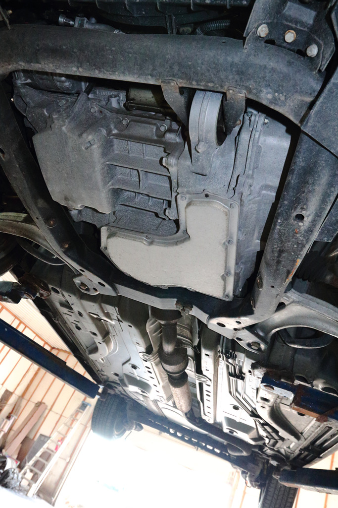

What you are calling the frame horns is actually the engine/transaxle/front suspension cradle, if it is bent it can be replaced, not repaired.
If the strut towers are out of whack there isn't much to do about fixing.
Just mentioning things to look out for. Maybe reasons that they totaled it.
Her son was in the marines, but she was from Indiana. the cradle was never even touched, and the bumper supports where they attach were called the front horns, the cradle attaches to the main frame behind the horns the bumper mounts to. We had it on the front end alignment rack before we test drove it, after getting a makeshift breather setup and everything inspected.

Well parts cam today, right fender, right headlight right fog light, and the bumper cover, fender and bumper are primed and painted. Wednesday I should have it done and ready for inspection,, I will find out tomorrow how far out that will be.
Washed it to and can see a few hail dings on the roof and hood,, but will live with em, very very minor, before I washed it they were not visible. It's a fish'n truck,, it'l work,,,
