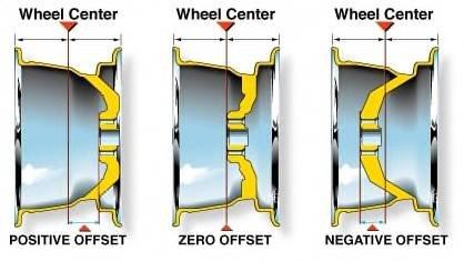

Solman-
I believe Cobalt SS wheels are 5x110 18x7 and offset is 42
The new rims kinda match your custom bentley grille.
Here's an offset diagram to give a visual..
