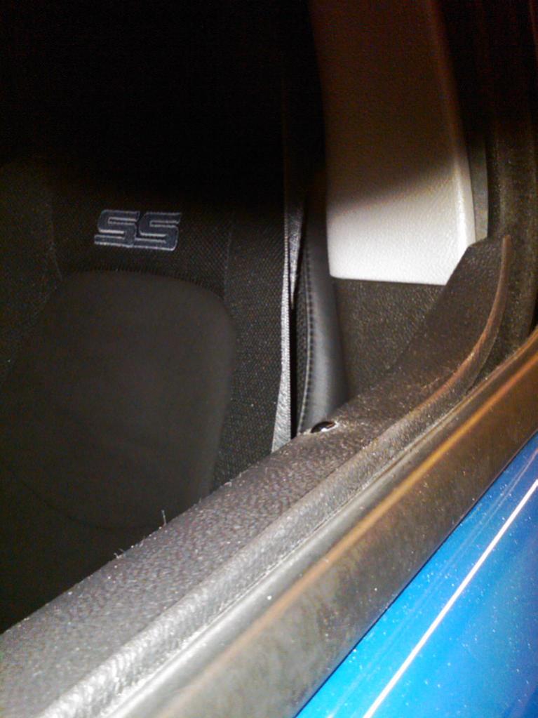

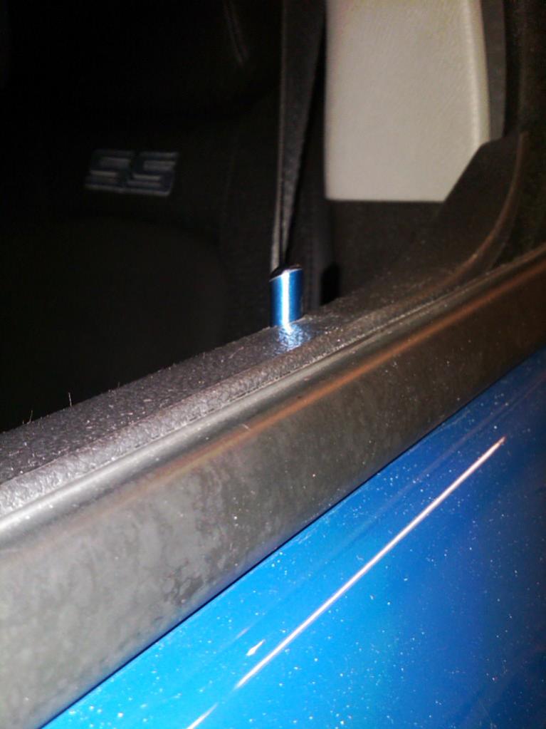

I've made 2 sets so far.
set I use now are made from 8mm round Aluminum bar stock (brushed finish)
these are anodized Aluminum tube (AKA knitting needle)
Attached Thumbnails Door lock knobs-img00125-20091211-1356.jpg   Door lock knobs-img00126-20091211-1357.jpg
