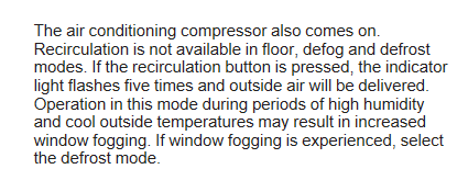

2. Recently the button on the right of the fan speed knob that toggles recirculation doesn't work. When I press it the light flashes three times and it aborts. Any ideas?

1. velcro
2. read your Owner Manual
3. that's odd
From page 3-23

2. The switch bank
