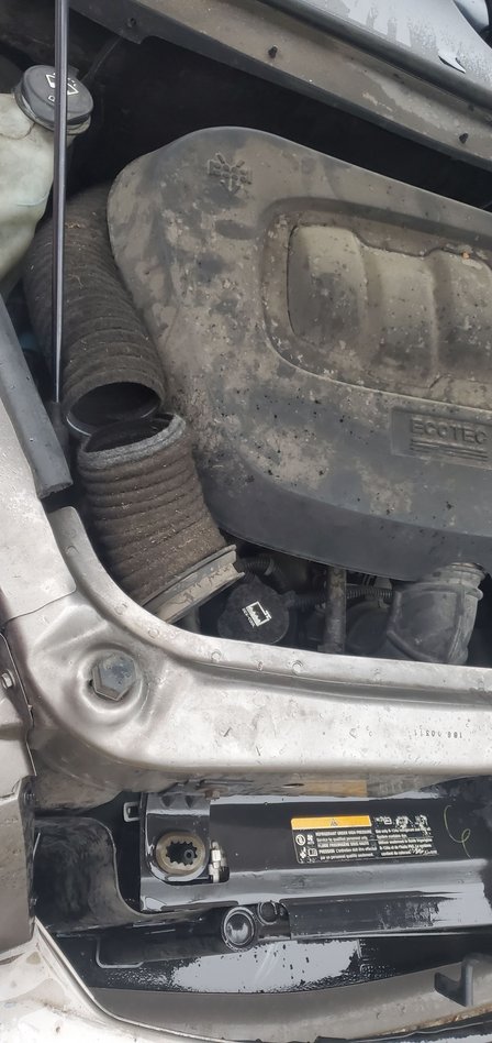

Im having issues with my 2011 2.2L engine. BUT-before I even go there-I eas looking under my hood just now and saw this "thing" just laying in there unattached to anything. Now I'm assuming that this end should be attached to something- right? And if so... where and ehat issues could it be making me have? (And definitely have to have another one bc it is so brittle-like that it tore when i picked it up) Thanks!
No clue how this is just undone!

The Famous Woolly Worm ! Many threads on here about it ! OEM is expensive but many tricks out there.
I have not had to change mine yet so hopefully someone who knows more will chime ! But type in Woolly Worm in search box

Idk how this came undone-I did break it bc its so dry-like! Can anyone tell me what & where this attaches? And wh
at issues would this be causing? Praying its the problem im currently having!!
Ok... Thanks I will do that. Dang thing just broke into when i pulled it out smh!!
Do u know where i hook it back into? The end with the rubber piece was not attached...

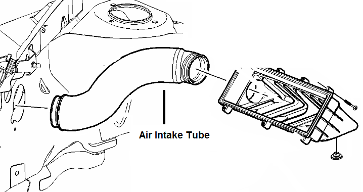

That’s called the woolly worm, it attaches to the air box then goes over to the passenger side inner fender to the 3” hole in the inner fender
What specifically is the problem you’re having?

Could be. The engine does better with cool air from other than under the hood.
Tape it up or replace it.

this "woolly worm" is just an air pipe.
Torn - wrap with tape or wrap with stretch film. Stick the loose end under the wing like Oldblue said.
But this pipe rupture cannot be the cause of poor engine performance. Look for the real reason. Start by describing the symptoms here if you want the guys to be able to make a diagnosis.
