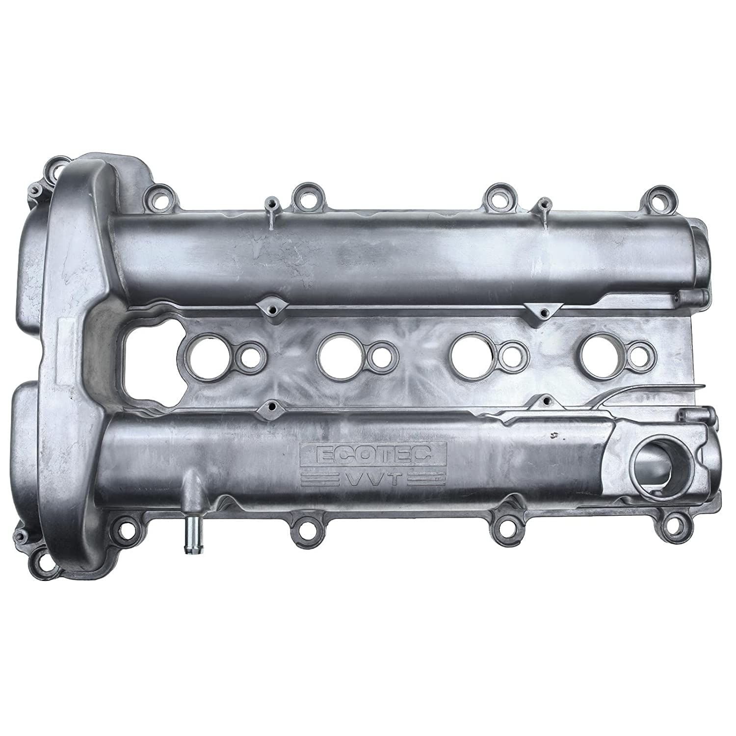

You’re on track, you must remove the valve cover to inspect the timing chain, just 10 mm and 13 mm bolts and a pvc hose.

Dying on the highway then cranking and not starting is pretty much the definition of a broken chain. The only other thing is something just up an fell off under the hood, pretty long odds.
